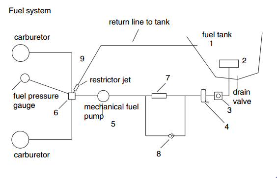

I found the below diagram. So in the below diagram, where would the return line sit between and the sensor? I am guessing the sensor is somewhere before the the elec fuel pump and the return line comes in inbetween the fuel pump and sensor?
The return line line is separated from the fuel spider and moved toward the mech pump to allow insertion of the FF sender. I will try and get some photos and post them up tomorrow.
Cheers, from what I have read, you can have the return line going either back to the fuel tank or back near where the line comes out of the tank (Correct me if I am wrong). If you do the second way though, you need to have it on the correct side of the electric fuel pump.
Sorry I could not get any good photos so I have edited your drawing a bit primitive.
It can be achieved with various brass fittings (I use mostly 1/8" npt bits off eBay.)912_fuel_fig_54_941.jpg.b4b604007868d3dc79155f734557b32f.jpg

Sorry I could not get any good photos so I have edited your drawing a bit primitive.It can be achieved with various brass fittings (I use mostly 1/8" npt bits off eBay.)[ATTACH=full]48770[/ATTACH]
I should have said 1/4" npt fittings

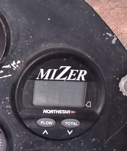

I have taken on a new project which has one of these Mizer Northstar fuel flow monitors installed, it is unserviceable. The company is long gone so replacing it with a new model is not an option. Is there an automotive or marine unit which is functional and sidesteps the aircraft price tag ? I have had a google sqizz and not had any joy, so all gems of wisdom will be gratefully received.
