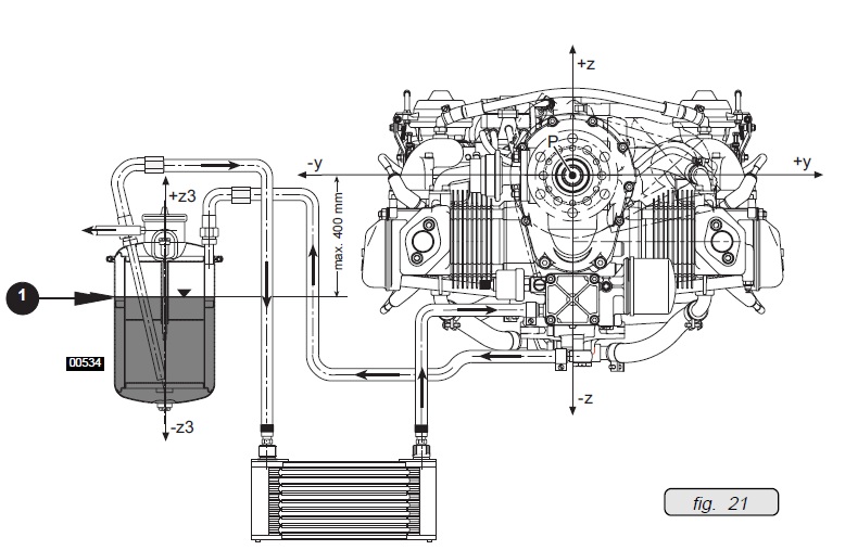

I'm Moving along with my maintenance, and I discover that my oil reservoir is alloy. It seems that many years ago Rotax issued a SB requiring replacement by a stainless steel tank. The alloy ones had been known to crack.
Anyone with a GA please tell me what tank you have and where it is mounted.
Mine has been modified (by factory), and it is located on the inside of firewall without an access hatch to check oil level. It has a non standard hose welded into the bottom of the tank, plumbed throught firewall to a dipstick in the engine bay.
So, to install the correct SS tank, I'll have to modify the fibreglass cowling to make an access hatch. Or get a non standard pipe welded into bottom of the new tank.
Any ideas?
Why not put new oil tank where alloy one is remember the height of of that tank is critical
I have this thought it's the same size different plumbing I don't like the idea of excessive welding of stainless steel
I would make access to dipstick as easy as possible

If it's 19xxxx or such just keep using it and inspecting it. Aluminium is used for many motorcycle and race car tanks. Arguably better than fibreglass. Your oil cooler is aluminium. Nev

It's a 55- registered factory built flying machine, so modifications are not allowed (without CAR 35 certification). Maybe I can drill a hole for the extra outlet, and fit a brass hose fitting secured by a nut on the inside of the new tank. That way it complies with the Rotax directive without modifying the aircraft (or welding anything)
Unless it's very thin I would modify it with an aluminium fitting and TIG it in place. Clean it out thoroughly at the same time. It's a standard repair technique. Can't be rocket science and aluminium is probably lighter than the alternative. Nev

Thanks to Doug for supplying me photos of his GA oil tank setup. I copied his as I believe that all GA912's after mine were made that way. I installed a ROTAX s.s. Oil tank. Deleted the external dip stick tube and blanked off the hole in the fire wall. I cut out a inspection hatch directly above the oil tank to allow access to the inbuilt dip stick.
