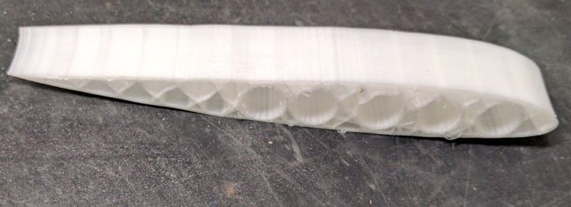

Geoff_H Posted December 24, 2016 Author Posted December 24, 2016 I tried to print a flap. Each segment to be made so a thin section aluminium tube could hold together each 200mm length of flap. To get it light I had thin walls of the flap. Printed one in nylon. It did not work, the youngs modulus of nylon is low compared to aluminum. With equivalent weight the nylon part was not Ridgid enough and flexed significantly.... Maybe a different material for printing will help some day.

Geoff_H Posted December 24, 2016 Author Posted December 24, 2016 This is a picture of the test part for the feasibility of a nylon printed flap. Notice the curve of the leading and trailing edge this could be remedied by a themally constant environment, or a heated box around the printer. It is light but not strong enough. 1
