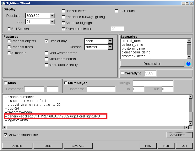

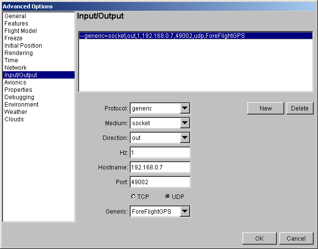

  4. Go to the advanced settings in the FGFS start up wizard, select input/output and create a new generic output entry which must be port 49002 and UDP. The host IP address should be the iPad as per step 2 above. See screen grab
  5. Ensure the settings appear as-expected in the command line output in the wizard as per the second screen grab
  6. Click the Run button on FGFS start up wizard
