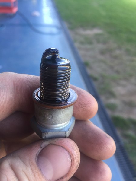

Update today:
On both plugs, #5 cylinder. Not a lot of sparking going on there. Cleaning away the liquid oil revealed a burnt "bridge" of oil.
There's 86 hours on the Hobbs and I'm 99% sure they're the original plugs (I don't recall any advice that they were ever changed during servicing). So that includes quite a few engine runs going all the way back to manufacture and ground testing. We were going to change them at the annual a few weeks ago because they're cheap as chips but the new batch we bought had some suspect markings on the ceramic parts and the originals were actually in pretty good condition, so we left them in.
Interestingly going back through engine download data I found that the cylinder actually dropped off line when it was previously run - which was a startup and short taxi from the hangar to the refuelling station. It dropped off 6 minutes after engine start, as I was waiting a few minutes with the engine running at just over 1000 RPM queued behind another aircraft which was refuelling. I didn't even notice it. Immediately after the refuel I went straight to the runup bay for my departure. Lots of good stuff to think about.
