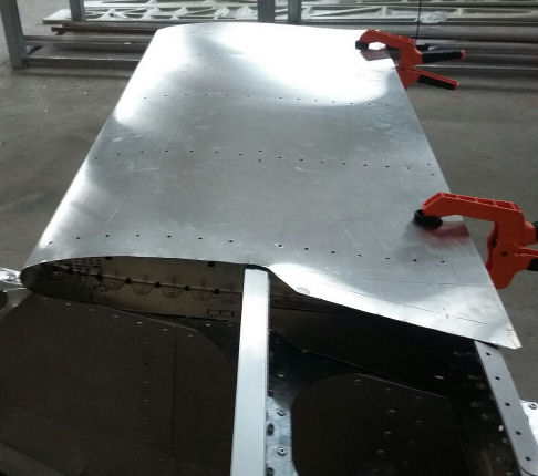

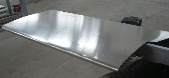

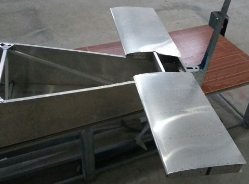

bexrbetter Posted February 27, 2017 Author Posted February 27, 2017 So, paid a bit more attention to the sheeting today, I am extremely happy that the matched holes all lined up on the rib's tab holes without any hassles. I was expecting to have to drill out some holes, and move them around on the computer 2D because the tabs are bent over each on a different angle to make the curve, this with the slightly varying radius as they are bent over by hand would not unexpectedly create some variances - but I got a little lucky there. .. But first I had to bend the sheets over for the front radius, never my favorite task, but went ok ...... 4

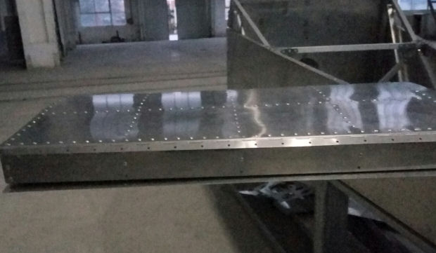

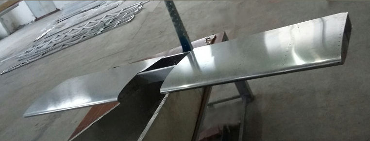

bexrbetter Posted March 1, 2017 Author Posted March 1, 2017 Mostly sheeted the HS but not entirely happy with my piano hinge mount arrangement for the elevator, so may change it yet ... I also picked up the 25mm spacing drilling jig strip rather than the 30 mm, so there's too many lateral rivets. 2

geoffreywh Posted March 2, 2017 Posted March 2, 2017 So when you bend the front radius of the elevator sheet how do you get the pre drilled holes to line up with the holes in the ribs ? There must be a jig or something to get the bend in exactly the right place, I mean, within a couple of thou. it looks as though that is really critical? ................The sheeting (from the picture) is already drilled. Maybe you drill the ribs after the bend? 1

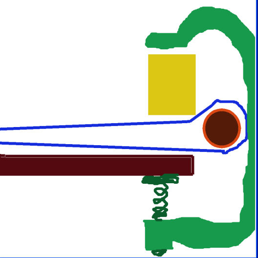

bexrbetter Posted March 2, 2017 Author Posted March 2, 2017 So when you bend the front radius of the elevator sheet how do you get the pre drilled holes to line up with the holes in the ribs ? There must be a jig or something to get the bend in exactly the right place, I mean, within a couple of thou. it looks as though that is really critical? ................The sheeting (from the picture) is already drilled. Maybe you drill the ribs after the bend? It's not that critical. There is 3 holes across the sheet (that are on the leading edge that need filling later) that I rivet to a 25mm pipe of sorts, thick plastic plumbing pipe in this instance. I merely wrap the sheet over the pipe, pop rivet 3 holes on the trailing edge and then push it down evenly with a strong 40 or 50mm square steel tube just behind the 25mm pipe with my body weight. I then do the final just behind the 25mm pipe with clamps over the edge of the table. 2 1

geoffreywh Posted March 2, 2017 Posted March 2, 2017 Fiendishly clever, the holes in the plastic tube are the jig! This is why I'm not a toolmaker!

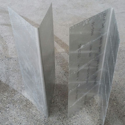

Bruce Tuncks Posted March 3, 2017 Posted March 3, 2017 The RV planes use a smaller pilot hole for the matched stuff. The hole is just big enough for a small cleco. So you need to remove a cleco, drill to size, debur, dimple and set a solid rivet. Maybe corrosion-proofing and maybe using a bucking bar. The Zeniths use full-size predrilled holes , I'm not sure if deburred, and pop rivets. Much easier and faster, but more drag. Bunnings garden sheds have holes to size and sheet-metal screws with sharp points. It takes a lot of skill to not strip the hole when you do up the screw. I hope it's not going to fly at all.
bexrbetter Posted March 4, 2017 Author Posted March 4, 2017 The RV planes use a smaller pilot hole for the matched stuff. The hole is just big enough for a small cleco. So you need to remove a cleco, drill to size, debur, dimple and set a solid rivet. Maybe corrosion-proofing and maybe using a bucking bar.The Zeniths use full-size predrilled holes , I'm not sure if deburred, and pop rivets. Much easier and faster, but more drag. I use both methods and whatever else is easiest for each particular situation.
