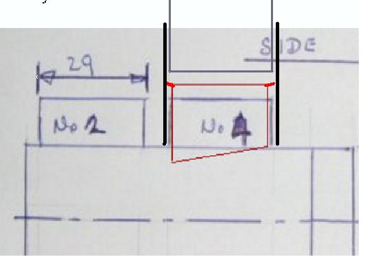

Thanks Bex, I had something much more drastic in mind. Like a finger coming out of the no4 pipe right into the stream..
I understand your finger idea, I've known about these things since I was a teenager.
It's way too long and it would flutter with the sonic pulses and break off in short time.
My tube idea only protrudes in a few mm's, prob 5 max and also allows you to rotate it and I suspect that having the pointy end closer to the plenum floor will be required rather than at 90 degrees (fuel falls quite quickly even in fast flowing air and it's already starting at the bottom of the stream so it would be literally coming in along the plenum floor) and of course it's strong.
You could put a lip on the end of the tube to be trapped between the manifold stub and intake pipe and tight enough in the rubber connection to not rotate on it's own.

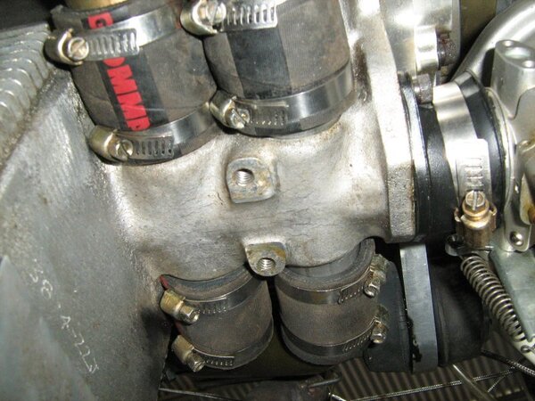

I am interested why #3 isn't running at the same mixture as 4, it should be in theory so have a good look for some issue between the carb and plenum maybe and of course carefully check #4 intake tract for leaks or other interferences.
It is quite possible that the differences in length of #3 and #4 tracts are sending signals back to the mouth's area that's perfectly timed to cause this issue. That would need a bit further thinking out if this simple fix doesn't help. For that I would need all 4 of the inlet tracts lengths from the mouths to the manifolds flange along the centreline as best as to the mm and I can do a bit of math to try to guess what's going on.
Hi jetjr, that new-looking sump-plenum is actually quite old, serial number 425. I think I am turning the clock back on you. The more modern setups are better I reckon.
Thanks Bex for the offer of analysis, I will measure up those pipes today. I can see that no3 is cool compared with no4 and therefore my thinking must be off-track somehow. On one take-off I saw 805 for no4 and 677 for no3 , and yet the take-offs are opposite each other and closest to the carby. There must be a swirl or something in jetjr's list that I am not doing right, as symmetry would indicate no3 and no4 should be equal, except for the slight difference in the lengths of the pipes.
On the force on the proposed finger-diverter: ( Caution..there could well be a big error in the following...)
If you assume the air has fixed volume and no inertia: The flow into the distribution box will look like a full rectified sine-wave. It will have instants of zero flow and then only flow into one outlet at a time.
3000rpm=50rev/sec. at 2 suctions/rev and each suction is 550cc. So averaged flow-rate is 50 times 1,100=55,000cc/sec
Average speed of flow through a 35mm pipe = 55,000/pipe area in sq cm=57160 cm/sec=57m/sec
Conservative average force on a 2sq cm plate in 57m/sec = 1/2 x rho x 57 squared x Cd x A =.39N since rho= 1.2 kg/sq m and A=2/10000 sq m.
I was surprised that there is a real risk of the finger breaking off. I thought the risk was having no4 running rich and the other 3 running lean. Right now, that result would mean progress. I would just trim down the finger .

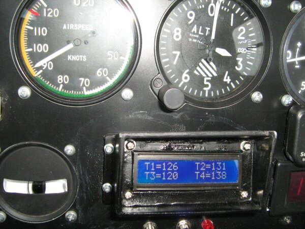

I wasted many hours trying to address the uneven egt problem, then removed the hose between the cowl naca and airbox.....
