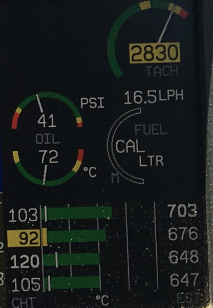

Jaba-who Posted April 17, 2016 Posted April 17, 2016 i still dont understand what the exact problem is? the actual numbers on the EGT are meaningless, as they can be effected by many variables giving different indications, as long as they are rising and falling at the same rate with changes in throttle position and mixture, then all is good. as said before, my EGT probes are just 1 inch from the exhaust valve, so read a lot higher than yours, and the front cylinders are in the cooling airstream, so read significantly less than the rear cylinders. this does not mean there is a mixture imbalance. just differences introduced by probe location conditions. a EGT probe 3 inches from the valve, will read far less than ones at 1 inch from the valve. mine read in the 900's! all thats needed to know is, are you rich or lean of peak? quick question, what is hotter? 50 deg RICH of peak EGT, or 50 deg LEAN of peak EGT? The only EGT spread that is of any significance, is the spread between Peak, Rich or lean of that peak in EGT between cylinders. the actual number of the peak is irrelevant, you just need to know when the peak is and which side of it your on. Sorry but this not true at all. You are throwing in a whole bunches of variables which don't exist. The engine in question appears to set up as per standard jabiru set up. So the variables you keep mentioning are irrelevant. You keep mentioning temp changes with mixture changes - your avatar says you fly jabirus but you seem to forget the pilot can not change the mixture on a jabiru. If - there is standardised position of the probes If - there is standardised airflow around the exhaust If - the jabiru standard test engine is the same set up as the engine in question And it seems it is - All of these seem to be true then yes there is significance in the raw numbers. Jabiru have produced a huge bank of numbers when engines run ideally and when run non-ideally and converted these into ranges which they advise are acceptable and which are not acceptable. The temps this engines cylinder four are achieving are not running in the ranges which jabiru says are acceptable so I can't see how you can suggest things are fine. None of the parameters you say make the temps ok exist in the situation we are talking about. 1
Ultralights Posted April 17, 2016 Posted April 17, 2016 mixture and internal cylinder pressures are the only thing that can influence the ACTUAL exhaust gas temperature in the cylinder can reach over 2000degC, the probe location, airflow within the exhaust pipe itself can all alter the reading at the probe, which actually reads an average. 2 things influence engine reliability, Cylinder head temp, and internal pressures. especially with aluminium head engines, such as the Jabiru. as higher than normal temps do a strange little metallurgical thing called artificial age hardening, resulting in things cracking. Yes, even a pilot of jabiru engined aircraft can influence the fuel mixture.. its called Carby heat. and you will be surprised how much it can change the mixture. with an understanding of the EGT probe data you can determine which side of the peak curve you are on with the addition, or removal of carby heat. Considering the actual temps at combustion can reach 2200DegC, i seriously doubt that its possible to achieve combustion at all and keep temps below 800degC flying a Jabiru, the only temperature i am concerned about is the CHT.. as this directly dictates the health of the engine.. detonation and pre ignition can be detected by monitoring CHT, whereas EGT will not. actually, a falling EGT and rising CHT is the signature of pre-ignition. this does far more damage than even mild detonation. and what i suspect is the contributor to most Jabiru issues. http://www.gami.com/articles/egt_myths.pdf 1 1

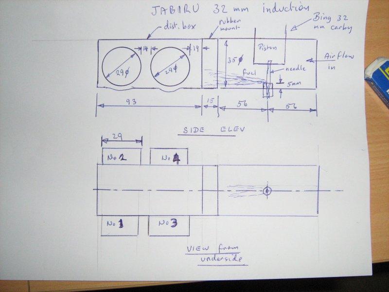

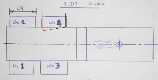

bexrbetter Posted April 17, 2016 Posted April 17, 2016 Today I took off the carby and had a look at things.The fuel comes in at 5mm from the throat bottom , which is only 88mm from the take-off to cylinder no.4 at the distribution box. You can see how tilting the top of the carby away from the hot cylinder brings the fuel plume closer to the take-off to the hot cylinder.I don't think the fuel has had time to mix uniformly with the airstream and no.4 is getting more air and less of the rich plume than is wanted, especially at full throttle. What about putting a small scoop out from the no.4 take-off to divert part of the fuel-rich plume into no.4? Think of the take-off hole to no.4 at the distribution box just downstream of the carby. Suppose a "finger" came out of this hole into the richer part of the airstream to divert some of this richer plume into no.4 Would this not richen no.4 at the expense of ( mainly) no.2? ( no.2 is the take-off downstream of no.4) I can't believe that I am the first to think of this... does anybody know of experiments along these lines? Yes Bruce, it's exactly how it works and is actually that logical and easy, i.e. fuel has a lot more weight and inertia than air wanting to travel straight when the air suddenly bends, eg; the air turns without the fuel (lean). These sorts of experiments to help deviate the heavier fuel's path will yield results and do mostly work in logic. Not experiments either, V8 production and aftermarket intake manifolds have been doing it forever, usually a small dam is put at the entrance of typically rich cylinder's runner, on the floor of the plenum and sometimes a trench leading into lean ones. Other more technical tricks are used also. Can you offer some drawings or good pictures of the intake manifold and layout? 1

Bruce Tuncks Posted April 18, 2016 Author Posted April 18, 2016 Thanks guys, I really appreciate the comments. Ul, the probes are all at 11cm from the flange, measured along the centerline of the pipe. There is not much airflow in the lower cowl past the probes. This cylinder has always been the hottest one on CHT, but the CHT's are ok generally less than 150C. But this cylinder was the one which had the exhaust valve seat fall out, so it does have a history of real problems. ( since this, I got a new head for no4 and naturally want this one to last) On tilting the carb: I forgot to say that I had done this to the extent possible, which is about 5 degrees. The top was tilted away from no4, which brings the below-center outlet closer to no4. It made no difference. Also checked the float level in the carby bowl and nothing was wrong there. I'll take some photos soon.
Jaba-who Posted April 18, 2016 Posted April 18, 2016 Thanks guys, I really appreciate the comments.Ul, the probes are all at 11cm from the flange, measured along the centerline of the pipe. There is not much airflow in the lower cowl past the probes. This cylinder has always been the hottest one on CHT, but the CHT's are ok generally less than 150C. But this cylinder was the one which had the exhaust valve seat fall out, so it does have a history of real problems. ( since this, I got a new head for no4 and naturally want this one to last) On tilting the carb: I forgot to say that I had done this to the extent possible, which is about 5 degrees. The top was tilted away from no4, which brings the below-center outlet closer to no4. It made no difference. Also checked the float level in the carby bowl and nothing was wrong there. I'll take some photos soon. Try tilting the carb the other way as well. I'm sure on my previous 3300 tilting the top TOWARD the hottest side made a drop on that side. On my current 3300 hasn't made any difference either way.
jetjr Posted April 18, 2016 Posted April 18, 2016 You can only tilt a little on one direction, forgotten which way The egt numbers presented AND those on the POH and maint manual, which we must abide by, are in a set of certain conditions. Distance from exhaust port, type of probe etcetc The combustion temps may well be high but not relevant as we are largely comparing the same data for different engines of the same make. 800 measured at the correct location is too high Results like Bruce is seeing are quite typical, if youll notice often you have the highest and lowest on the same side, and the rest of engine sees numbers centred between these outliers. The correct volume of fuel is there just going the wrong place. To achieve the same change in mixture and resultant egt would require dramatic jetting changes and big reductiosn in fuel flow. Like dropping flow from 27lph to 19lph. Jabiru tried this with an economy jetting kit. Many engines failed with burn valves and overheating problems. This was reversed and new jetting recommended due to damage caused. The whole argument of LOP cannot be used sucessfully unless mixtures are even. Yes carb heat can influence mixture but not incrementally, it goes very rich and sees reduction of power. Hardly mixture control. Also the self adjusting bing doesnt do much of a job either.

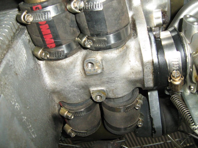

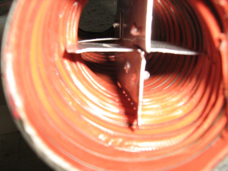

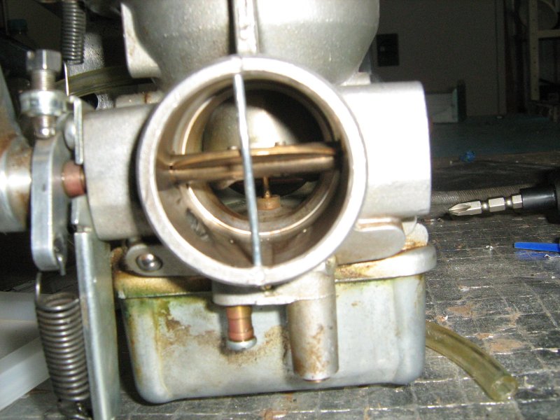

Bruce Tuncks Posted April 19, 2016 Author Posted April 19, 2016 Here's the setup. I guess it looks old-fashioned to guys with new planes. The first pic is the underside of the distribution box. The second pic is the crude and apparently quite ineffective flow straightener in the SCAT hose coming into the carby. The third pic is the ineffective "turbulator" wire in the carby outlet. The last pic is the internal dimensions of the inlet flow system.

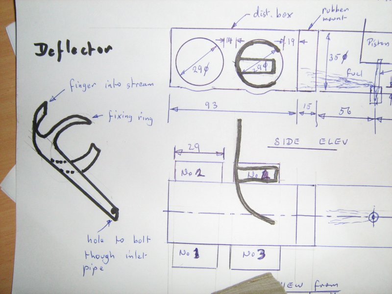

Bruce Tuncks Posted April 20, 2016 Author Posted April 20, 2016 Thanks Bex, I had something much more drastic in mind. Like a finger coming out of the no4 pipe right into the stream. After the things I've tried that did nothing, I thought it was time I did something too much. What do you think this would do? On the sketch, the long tail bit with the hole is to fix the thing where the bolt will not interfere with the rubber joiner bit.
aj_richo Posted April 20, 2016 Posted April 20, 2016 Assuming you're making it out of metal, Id be worried about potential fatigue and sucking parts it into the cylinder.. 1 2
