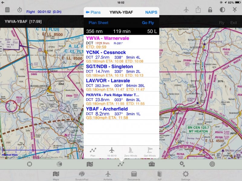

One thing I noticed when playing around, my RV9 is configured to use SMPH, but the flight planner uses NM by default, and at the planned ground speed of 180 instead of 180MPH, uses 180Kts, giving a misleading impression of the flight being shorter than it really is.
I haven't let the OzRunways folks know yet, but will when I get home with a screenshot.

One thing I noticed when playing around, my RV9 is configured to use SMPH, but the flight planner uses NM by default, and at the planned ground speed of 180 instead of 180MPH, uses 180Kts, giving a misleading impression of the flight being shorter than it really is.I haven't let the OzRunways folks know yet, but will when I get home with a screenshot.
If I understand your problem correctly, you only need to go into "settings/aircraft" scroll to the bottom, and change units from Kts to MPH.
The problem is that I have already done that but it hasn't carried over to other parts of OzRunways.
The RV-9 is already configured to use SMPH, but the flight planner doesn't recognise that, defaulting to Knots, even though the planned legs are based on 180SMPH, this throws the timing out. Hopefully the screenshot will work, you can see the trip is based on a distance of 356NM, and at 180Knots would take 119Mins. But the individual legs are specified as flown at 180SMPH, giving a 17 minute difference.
And just a quick follow-up, I emailed the OzRunways crew about it, and got a reply a couple of hours later (try that with Telstra, or the bank...). It is a bug and they should be able to correct in the next release. 001_smile.gif.2cb759f06c4678ed4757932a99c02fa0.gif
