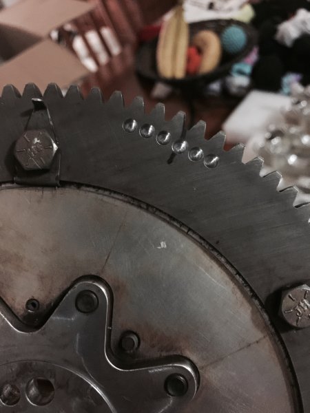

deadstick Posted September 18, 2015 Posted September 18, 2015 One dynamically balanced 2200 flywheel for a friend. 1
Oscar Posted September 18, 2015 Posted September 18, 2015 You ARE having a bit of a joke - right? To be dynamically balanced as a flywheel, it requires to be mounted onto the crankshaft on which it is used and referenced as to mounting. Are you including the actual crankshaft in the offer? 1
deadstick Posted September 18, 2015 Posted September 18, 2015 Lol, no mate just the flywheel! Seriously and no jokes!!! Your basing that statement on your 'in depth' and 'vast' experience in jabiru aero engine building I take it?
facthunter Posted September 18, 2015 Posted September 18, 2015 You are being a bit hard Oscar. If everything runs true, the parts can be balanced individually, and the end result is good. I would suggest you don't put the holes so close to the base of the gear teeth though (next time). Nev.
Oscar Posted September 18, 2015 Posted September 18, 2015 Lol, no mate just the flywheel! Seriously and no jokes!!! Your basing that statement on your 'in depth' and 'vast' experience in jabiru aero engine building I take it? No, just the physics involved.
Oscar Posted September 18, 2015 Posted September 18, 2015 You are being a bit hard Oscar. If everything runs true, the parts can be balanced individually, and the end result is good. I would suggest you don't put the holes so close to the base of the gear teeth though (next time). Nev. Balanced individually, is not dynamically balanced to the assembly. An assembly of individually balanced components can statistically allow the sum of the worst tolerances to align. In the case of the crankshaft to flywheel assembly - especially with reference to the harmonics in the crankshaft at certain frequencies - it is the assembly rather than the individual components that needs to be tested. 1
deadstick Posted September 18, 2015 Posted September 18, 2015 Hi Nev, it's not my work mate it from Camit, I don't have the gear and a little bit out of my comfort zone to be playing around with flywheel balance on an engine that's been plagued with issues. And yes Oscar it's dynamically balanced! or am I missing the physics and all? LOL
deadstick Posted September 18, 2015 Posted September 18, 2015 No one mentioned 'the assembly' Oscar! In fact Ian stated that it was not required, go figure I trust he knows better than I in this topic. Are you ever positive or helpful? You come across as downright nasty and spiteful, though it can be hard to accurately read tone in a typed statement.
facthunter Posted September 18, 2015 Posted September 18, 2015 Oscar, I don't agree. Harmonics is length and mass to stiffness considerations, None of which you are correcting or measuring. It's not practical to rule out individual component balance. I did say if everything runs true. Balancing an assembly means you must continue to do it that way. as only the final outcome is assessed. Any change to the position of components with your method is bound to result in an unbalance.(in principle) Nev
