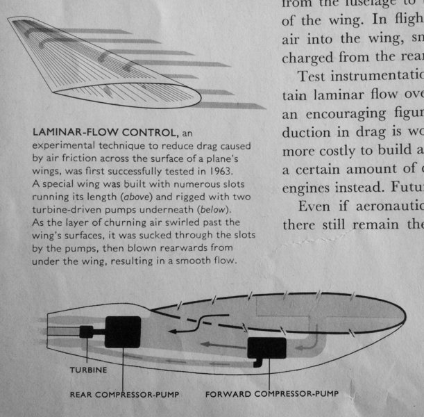

Not interested on anything like rotating cylinders, just improving the laminar flow at higher angles of attack by blowing the boundary layer to stop separation occurring for longer. This isn't rocket science but the plane will be propelled by the same feature. At low angles of attack you don't have a problem with separation. That's when it will provide more thrust. Nev
Fascinating discussion, people! I believe one version of the C-130 Herc blew air out slots in the wings, presumably into the flaps gap.
This snippet about laminar flow comes from my first book about flight, published 1966:
