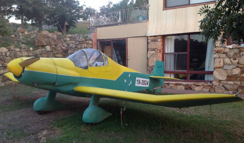

Old Koreelah Posted January 20, 2015 Posted January 20, 2015 In response to a bit of interest shown on another thread (http://www.recreationalflying.com/threads/airasia-flight-qz8501-missing.128911/page-7#post-471045) here is my Jodel-building story. The Jodel Story The Jodel story starts with two French aviation enthusiasts, Edouard Joly and his son-in-law Jean Delemontez. They worked together repairing and designing aircraft before WWII. After the war they combined their names in a new business: Avions Jodel. The first design actually completed and flown was the D9. It was greeted with enthusiasm and within five years 200 of them were flying in France. "...The basis was light weight, together with strength (the design load factor is +9g -4.5g at 600lb.) and simplicity and careful choice of materials. Much thought went into the wing design which is after all the most important part of any aeroplane. Delemontez said, "It had to be simple, an elliptical plan form is the most efficient, like the Spitfire, but it is very complicated to build. I wanted something which was straight forward, so I decided on a flat rectangular centre section of constant chord and aerofoil section which avoided laminated spars, and could be built around a box section spar which was not only extremely strong but was also light. It had to be very efficient also." “An NACA 23012 aerofoil section was chosen for the rectangular centre section, the up-swept tapered, outer panels changed both in incidence giving washout, and in aerofoil section. Thus in level flight the main lift comes from the centre section, the outer panels giving little lift and very little drag. However in the climb and at the stall the outer panels are designed to contribute to lift and stability. ( The former quality because at the stall the outer panels have a positive angle of attack, the latter quality because the inner part of the wing stalls before the outer.) This enables a very low stall and landing speed. So the wing was designed and became known as the "Delemontez trapezoidal planform"..." This came from a history of Jodel written here in Australia by Frank Rogers, who had drawn improved plans which are still used by builders throughout the world. Larger Jodel models were built, carrying up to five people, mostly being constructed from plans. It is a tribute to the design of the little D9 that many are still flying today and the basic design has been extended so much. Frank Rogers' history of Jodels: http://www.jodel.com/index.asp?p=rogers1&articles http://jodel.com/index.asp?p=rogers2&articles http://www.jodel.com/index.asp?p=rogers3&articles http://jodel.com/index.asp?p=rogers4&articles http://www.jodel.com/index.asp?p=rogers5&articles http://www.jodel.com My Jodel Story: I bought my little Jodel D9 because it was the best aircraft I could afford and it offered scope for significant improvements. I have progressively modified it to improve safety and utility, based on advice from Frank Rogers and M. Delemontez- the original designer. First I enlarged the cockpit to fit my 1.94m frame. The fuselage was split down the middle and widened at the cabin by 100mm. The seat was laid back and the turtle deck raised and streamlined. An extra pair of spruce longerons were added to connect this to the firewall, which was moved forward. The floor was lowered about 60mm, streamlined and curved. I added a couple of belly doors for access to the fuel system and rear fuselage. I built a canopy to suit (learning a lot about bending acrylic in the process.) The canopy slides at the front and has radius arms at the back. It can be opened in flight, but airflow makes it want to slide shut. Engine: The original Stark-Stamo engine was at the end of its reliable life and I was persuaded to replace it with a 1600 VW. Despite my protests, they insisted that iron barrels were the only way. I missed that warning bell... A starter motor was a safety priority to me, after the old engine stopped a few times on taxiways. It was more than the inconvenience of having to undo the harness in the tiny cabin and clamber out to restart the donk. Although starting was easy, there was always the danger of making a mistake around a spinning prop. After much searching, I found a tiny starter off a Yamaha outboard. It turned the right direction and I mounted it on the oil-pipe studs at the front of the engine. After some intricate work with an angle grinder, I adapted it to mesh with the ring gear from a Holden 202 Automatic. I have no lathe and had never used one, but made a 340mm diameter spinner on a spindle mounted vertically in a bench vice and shaped with hand tools. Electric start meant I needed a battery and a charging system. I got a Kubota dynamo out of Tennessee and mounted it belt-driven off a pulley on the rear of the engine. To avoid the ugly bump seen on so many VW cowls, next came a low-profile electronic ignition system. After encasing the engine in glad-wrap, I built a streamlined fibreglass pressure cowl around it. Ground testing the engine with the original Hoffman prop showed everything working well. All this took a couple of years; my dream was to fly it to Narromine for AusFly. Other builders would understand the frustration as each Easter came and went. Despite my best efforts to keep it light and carefully weighing each component, I got a nasty shock when I borrowed some digital cattle scales from a neighbour. My two years of effort was wasted: the beast was hopelessly nose-heavy. With morale at rock-bottom I ripped the whole lot out and spent up large on the engine I had originally wanted. After all that practice, fitting the third motor was much easier. It weighed far less that the VW and had mobs more power. Thank you Jabiru! I designed a new engine mount and tacked it together in a plywood jig- then took it to a proper aircraft welder who did a neat job of it. Building a new pressure cowl around the smaller Jab engine was relatively easy. I enjoy creating complex and functional shapes in fibreglass. Modifying the exhaust system to fit the narrow cowl was harder. No local welders would touch anything from an aeroplane, so I had to do it myself. Not neat, but functional. Aircraft Carrier I modified the plane so I could fold the fuselage around over the wing for transport and storage. The original idea was to be able to do this at the end of a long trip, but I had to make the whole process dependent on the dedicated carrier. This is what it looked like a few years back: A summary of innovations in the design: Safety Windows in floor to improve visibility Spring-mounted wingtip strobes resist hangar rash Automatic crash-activated battery isolator Impact padding under seat & canopy (I also wear a helmet) Cockpit double layered with plywood: increased strength, to reduce chance of spruce-inflicted splinter injuries in accident BRS parachute Trim wheel incorporating back-up elevator control Sealed battery, isolated behind firewall Digital CO detector Fire extinguisher plumbed into engine bay Chrome-moly canopy hoops; alloy centre member to carry fence wire over pilot’s head in a crash Impact-resistant 2mm polycarbon windscreen; acrylic canopy to allow break out in event of flipover Landing lights Bright yellow paint above & darker green underneath to improve visibility Fuel System Wing tanks rubber-mounted behind spar, wrapped in kevlar, with vent tubes to wingtips (large-bore to carry pressure pulse in a crash and if inverted, to drain fuel far from cockpit) Wheels 6X6 tyres for rough fields Disc brakes Streamlined wheel spats, quickly removable. Tailstrut Home-made, streamlined glass/carbon fibre tailstrut, mounted concentrically with rudder, adding to rudder effect Comfort Fuselage widened 100 mm Cockpit rear section laid back & head-room increased Cabin floor lowered 60mm, widened & reinforced Arm rests stiffen sides & facilitating exit Steamlined canopy to reduce noise Fibreglass seat moulded to pilot’s backside Efficiency Drag reductions- large spinner, wing filleting, streamlined fuselage & undercarriage Engine cooling air exits in the low-pressure zone above the wing Storage Luggage bays- behind firewall & behind pilot Door under wing for access to rear fuselage- storage of empty fuel drum, suit, or backpack Tools & tie-downs stored behind firewall Ground transport Pitot, fuel lines & electrical connections bundled into one “umbilical” allowing fuselage to pivot over wing Loading plane onto carrier & folding for transport takes one person 20 minutes; no controls are disconnected After years of building all these improvements into my little plane, I entered it for judging at AusFly, hoping it might get a mention in the innovation section. I must confess to some disappointment when the judges showed no interest in my offer to demonstrate some of the safety features. A great paint job seems to be more important. Wing All the added weight increased the stall speed. To compensate, the wing was rebuilt larger, to D18 specs and flaps added. The Jodel wing is remarkably efficient, but it’s planform increases the risk of wing drop at the stall. To counter this, wing fences and stall strips were added. The carrier required a bit of surgery to allow the fences to fit. Testing to get the best low-speed landing performance is ongoing. Blunders It’s said that humans possess forty types of intelligence, but that most of us are lacking in one or several departments. After much hard experience, I finally discovered that one of my deficiencies is no capacity to understand how long it will take to do something. (My 5-year house is still unfinished thirty years later. Somehow, my better half is still with me.) With the next Easter far away, I thought there was plenty of time to add one more innovation to my new aeroplane. Efficiency is everything right? Good designers maximize performance. Why waste all that heat from the engine? I read up on exhaust augmentors and became a convert. Augmentors were once common, especially on aircraft built by Canada’s de Havilland. They do a great job of sucking cooling air through the engine. I could not understand why they had fallen out of favour so, armed with the results of NACA research done in the 1940s, I built a matching pair each side of the forward fuselage, exiting beside the cockpit. They added about 4kg, but flight testing with them installed and then removed showed 4% faster climb rate and better cooling. I was so pleased with my own cleverness I put up with the ear-shattering howl as the engine came on song. After my first long trip, to Temora, the first thing I did was buy a good NC headset. This reduced the horrible noise, but I soon removed the augmentors, re-routed the exhaust under the cowls like everyone else, and didn’t notice the marginal loss of climb performance. Cooling is still okey, because the low-pressure zone above the wing helps suck plenty of air through. Anyone want to buy a hardly-used, top brand NC headset? An ag pilot once told me that the tailwheel has to take a lot of punishment. Ignoring this hint, I went ahead and replaced my robust, but heavy solid roller with a light, streamlined Bunnings-grade plastic one. It failed on my first trip. An after-hours hop over the fence of Temora’s lawn-mower repair shop yielded a Victa front wheel which got me home. After three more Bunnings wheels I fitted one off a wheelchair and all is well. Performance At MTOW my D918 can get off the ground in 160m, but the landing run is considerably longer. It is now a useful long-distance tourer- as long as I keep luggage to a minimum. My wife helped me cut down our 1970‘s Big-W tent so that it slips over the left wing; no poles required, saving weight. It’s a delight to fly. Cruising high above the turbulence I can fly hands free and steer it with movements of my head. Best cruise speed is a compromise: keeping under the 100kt limit of the Jodel and above the Jabiru’s vibration band at 2400rpm. At 2800rpm (90+kt) it burns 12.5 litres per hour. At 2600- (80kt) burns 10 litres. Fifty litres gives a safe range of 320nm. Experimenting with my improved new CHT/EGT gauge might stretch this beyond 350. 5 2 9

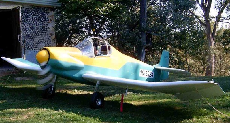

Old Koreelah Posted January 20, 2015 Author Posted January 20, 2015 Nose reminds me of a FW190D...gear off a Stuka...? Canopy off a p51 ...and wings off one of those "clipped" spitfires....How do you find the spats and are they fixed with the wheels moving up and down inside? Sounds like I got bits out of an old Warbirds parts bin! The reality: I was no doubt influenced by those iconic designs. The canopy, like everything else, is my own design. It took months and I still didn't get a perfect curve on the perspex. After a lot of reading about aerodynamics, I built the spats the hard way. Two months grovelling around under the wing in 40+ degree heat. I wrapped the UC in glad wrap and built up "planks" of Klegecell to shape them. Then lots of shaping with hand tools, a few layers of fine glass and cut thru them vertically. They are mounted on the axles and slider, and open quickly for inspection. They come off totally in a couple of minutes. I was never a fan of ugly big wheel spats but thought they'd help extend the glide if the engine failed. I did extensive testing with them on and off and was amazed at the difference they made: At 2800rpm speed increased 4%, fuel burn reduced 8.43%. At 2600rpm no noticeable speed benefit, but fuel burn down an amazing 13%. That must be the cruising sweet spot. 2
