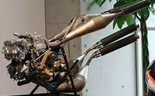

bexrbetter Posted December 12, 2014 Posted December 12, 2014 3 cylinder...... firing 120 degrees apart? Yup, exactly. Can gain a decent increase in horsepower due to the ability to use exhaust pressure waves of a previous exhasted cylinder to enhance the currently filling cylinder. Minor reversion supercharging but not nearly as effective as an expansion chamber. That's only an advantage if you don't have the ability to use individual expansion chambers and note that 3 CR500 engines make 200hp standard from 1500cc with chambers rather than Martin's 4 cylinders and 2000cc. For their application though, 3 expansion chambers would be difficult to package. I would suggest they could have gotten around 180hp using just 3 cylinders with good packaging, maybe it wasn't enough though. And just to show the potential, the last years of 500cc Moto GP were regularly getting over 200hp from their 500cc 4 cylinder engines, but you can see here just how difficult it is to package the 4 chambers and for the Martin application the chambers would have to be substantially larger for the required lower rpm power band.
