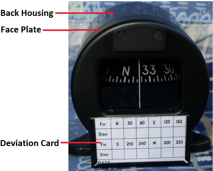

This may help:
You can see that there is a line between the Back Housing and Face Plate, that is because they are two separate components. The Mounting plate at the bottom is attached to the Back Housing. At the rear of the compass there is a screw that attaches the Back Housing to the inner frame of the compass of which the Face Plate is a part of.
You loosen off the screw and turn the Back Housing around 180deg and then tighten the screw. It is basically just a barrel with the mounting plate attached to it. This then places the mounting plate at the top of the compass.
The Deviation Card is attached to the Face Plate so it remains where it is. BUT it would be very very important to ensure that after turning the Back Housing 180deg that you do so exactly 180deg
