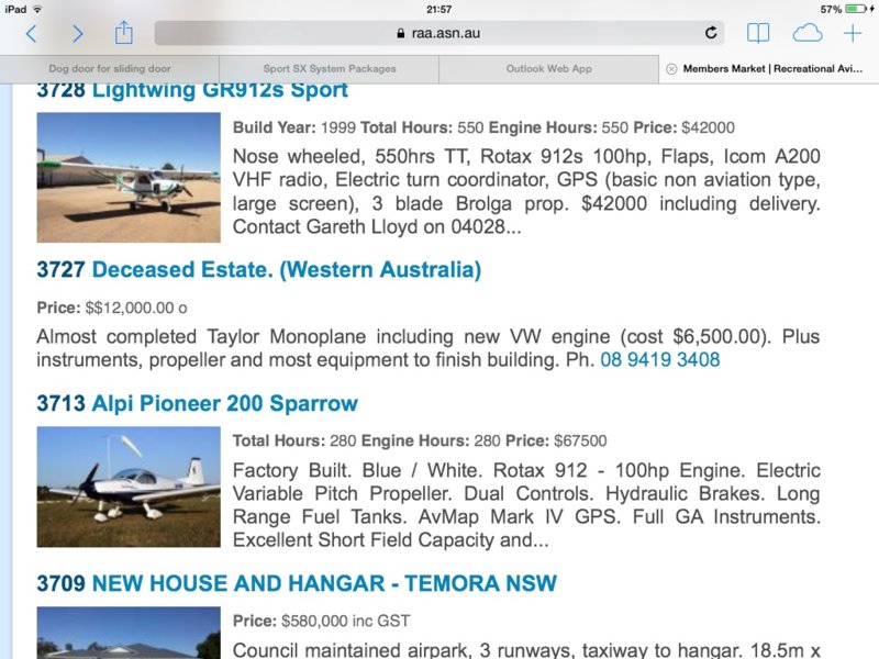

flyvulcan Posted July 16, 2014 Posted July 16, 2014 John, There's a project for sale in WA at the moment. It's on the RAAus members market. You could get a real head start. Cheers, Dave 1
