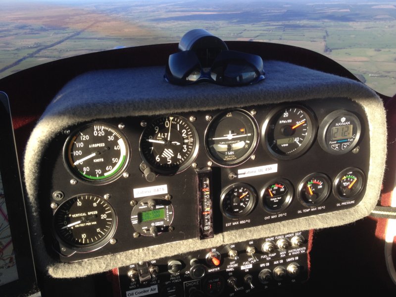

Keenaviator Posted May 7, 2014 Author Posted May 7, 2014 Very pleased with the way this machine has turned out. It flies straight and engine temps and pressures excellent - the under cowl mods work a treat. It's running a bit rich (exhaust pretty dark and a slight miss at WOT above 2500' that gets worse with carby heat as expected - will investigate jetting/needle position). It glides very nicely too with those long wings. Sink rate at MTOW about 400 fpm (engine off with CFI for company). Cheers, Laurie Â

Keenaviator Posted May 9, 2014 Author Posted May 9, 2014 Thanks Laurie,Good to see someone who understands and works to the basic principles. How 'bout some pics of the under cowl work? 15c ambient is fairly cool, sounds like southern highlands weather. It will be interesting to see what results you get on more extreme days. What's the vertical gauge mid panel? Do you plan to monitor all CHT's & EGT's? I'll put together some photos soon.... The outside temp at 2500' I guessed since it was 18 on the ground. I found today why it has been running so rich - I checked the main jet and found it was a 255, normally fitted to a 3300. That's why the fuel flow numbers have been more like those for a 3300, not a 2200. Anyway I was given a 235 main jet to try and it seems better. I'll get the 245 main and recommended needle and needle jet for this motor asap because I wouldn't be surprised if it is fitted with those for a 3300 as well. The CHT and oil temperatures remained the same with the smaller main jet. The engine is now due for its first head tension and tappet check. Think I'll now hold off on further flying until I can get my hands on the proper needle and jets. Regarding full monitoring, I'd really like to but probably at bit hard to get past the finance minister and the moment. For now I'll stick with monitoring the theoretical hottest and leanest cylinders and checking the colour of spark plugs. Regards, Laurie Â
Keenaviator Posted May 9, 2014 Author Posted May 9, 2014 Thanks Laurie,What's the vertical gauge mid panel? It's a simple 'G' meter. No need for it really, had it lying around from my last project which ended up having a better one installed. Laurie
