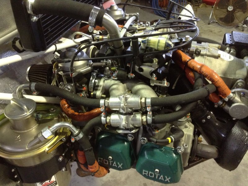

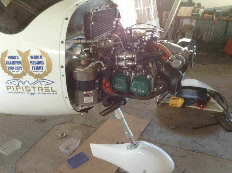

Referring mostly to thermostats....Evans is an approved coolant for the 912....not sure if oil thermostats are recently standard.....the Pipistrel I have just worked on has one, but not sure if its standard or not.....the Rotax service letter mentions many things, bring it up and have a read......................Maj....
