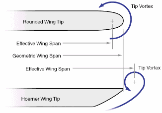

Chris Heintz (one of the CH701's designers) illustrates it like this:
If the Hoerner wing tip works as illustrated, you get something (in this case, wingspan) for nothing. However, that is 20th century technology, started by much earlier by Hoerner and adopted by Heintz/Tedesco in the 1980s on the Zenith aircraft.

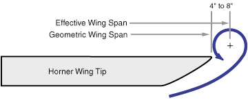

Heintz claims that the Hoerner wing tip expanded the wing by 100-200 mm (per wing):

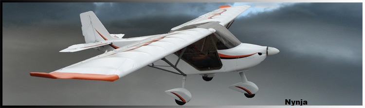

Lately, there are other wing tip designs found on RA-Aus style aircraft. One is advertised by a supporter of this forum, the Nynja. Here, the wing tip device is an upswept one:
One wonders what would be the best wing tip for 19-xxx high wing plane? Any thoughts??

It adds bending moment. It adds a lot of root bending moment. Any effective tip device does. The winglets on one of the Cessna twins - 421 mebbe? - drop the fatigue life to ~1/4 of the life without winglets.
The Hoerner tip produces less bending moment than a winglet, and less benefit than a winglet; if you want the benefit of higher aspect ratio, build a bigger wing. There are far better places to improve most aeroplanes than the structurally arduous wingspan extension.
Airliners use winglets for hangarage reasons, not because they're better than a span increase.

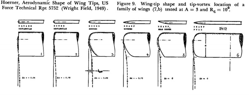

Consider one item in the recent development of the Xtreme Decathlon from the Super Decathlon. More power so rate of climb is good but another design objective was to increase the roll rate - reduction in wing span helped achieve that. The neat wingtip was removed leaving a blunt tip - compare effective aspect ratios between #1 and #5 to help determine what is lost. Then consider the reduction in profile drag. And a weight reduction which helped to compensate for the heavier engine.
Mix that in with the other design changes and the Extreme is a much better airplane than the Super all round.
