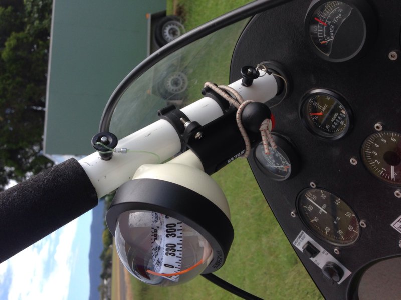

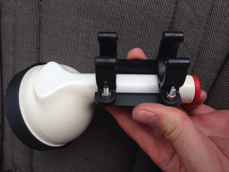

dustinwoodhouse Posted February 28, 2016 Posted February 28, 2016 [ATTACH=full]27621[/ATTACH] Took a couple of pics of my mount[ATTACH=full]27620[/ATTACH] Mark11, that's an awesome mount, where did you get it? I've been using electrical tape and it's not very stable..
Guest Andys@coffs Posted February 29, 2016 Posted February 29, 2016 Trap for young players.... If the mount can easily move relative to pointing straight forward then when using compass only for navex then best ensure there is a Line on the pole and the mount that you can check to ensure that aircraft and compass both point the same way..... When I did my cross country everything was constantly out....wasn't till I got home that I worked out why... Andy Oh and as a suggestion any hardware used in the mount needs to be non ferrous..... Brass preferably, so as not to affect accuracy. Can't tell for sure but the bolts and captive nuts look either steel or stainless, both sub optimal....
Mark11 Posted March 2, 2016 Posted March 2, 2016 Mark11, that's an awesome mount, where did you get it? I've been using electrical tape and it's not very stable.. The mount bracket came with the compass. The clip ons I bought from The yacht shop lake Illawarra- Wollongong
