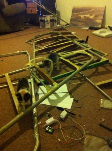

XP503 Posted February 23, 2014 Posted February 23, 2014 The ribs in the tail feathers are foam cut to fit snug and held in place by anti-chafing tape. Here is a photo of the internals. Sorry about the messy junk room.  1

XP503 Posted February 23, 2014 Posted February 23, 2014 Horiz stab is only attached by the 4 cables that go from stab up to rudder and stab down to boom Â
seb7701 Posted February 23, 2014 Author Posted February 23, 2014 M61A1 - had that exact thought, even if the inboard hinge has to be removed, but might be enough slack not to need to. Just need to track down the foam. XP- bloody ripper - I was hoping that the wires would undo and the horizontal just slips off some pins or something, given the lack of other obvious attachment points!! Awesome! Thanks again for the snaps, as it really made it easier to picture what i was dealing with. Hoping to pull out the old one(both pieces...), use as template and go again. Thankfully the broken one is the largest, which is closest to the inner seam. So tell me, if there are foam formers in the tail, then the wings have bent tubing battens I am guessing? Thanks again men, seriously! Â

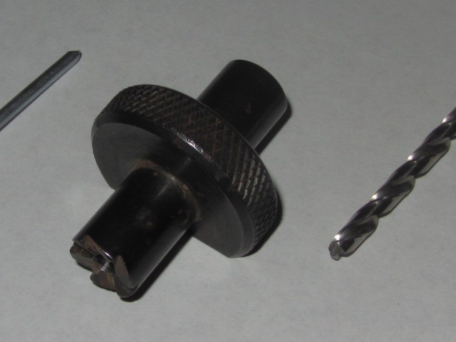

M61A1 Posted February 24, 2014 Posted February 24, 2014 Just a short note about rivet drilling.....try really hard not to let the rivet spin as you drill it. There are a few techniques for this, 1.if you can, hold it from the back (unusual for a blind rivet) 2. drill at a slight angle 3. drill in an oscillating motion (carefully..it makes the hole you make slightly larger than the drill size, so it can't grip the sides) 4. get some sidecutters under the front to hold it. Once they spin they are extra hard to get out, especially if they are stainless, which most Drifter rivets are, and it makes the hole oversize.  2

merc Posted February 25, 2014 Posted February 25, 2014 Just a short note about rivet drilling.....try really hard not to let the rivet spin as you drill it. There are a few techniques for this, 1.if you can, hold it from the back (unusual for a blind rivet) 2. drill at a slight angle 3. drill in an oscillating motion (carefully..it makes the hole you make slightly larger than the drill size, so it can't grip the sides) 4. get some sidecutters under the front to hold it. Once they spin they are extra hard to get out, especially if they are stainless, which most Drifter rivets are, and it makes the hole oversize. You need one of these, using your fingers on the knurled part , hold the serrated end on the rivet head , then drill through centre of tool with a bit slightly smaller than rivet . dont know the brand name but got it from america a few years ago. works a treat. cheers , tony   2
seb7701 Posted February 26, 2014 Author Posted February 26, 2014 Thanks Tony - ebay here I come... Â
