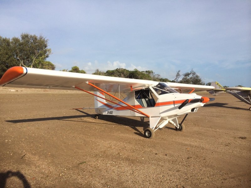

I personally have owned two of the GR versions 25 0032 & 25 0229 .. Love them .image.jpg.7950851bd6a700f8c52cafd25cb0d32d.jpg
