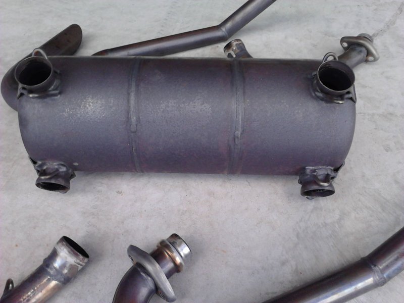

Downunder Posted October 27, 2013 Posted October 27, 2013 Any half decent exhaust place can do it. They would be experienced with welding thin wall tube. If your exhaust system is not stainless then you might want to think about getting it coated.....The "before" pic was from only 6 months old. Aircraft always in a hangar. The salty air on our coast doesn't like Austrian steel by the looks. Not a particularly cheap exercise but ALOT cheaper than a new exhaust system......Had mine done here http://www.cicceramic.com.au/ Due to the high temps, it does fade a bit.......

Guest Maj Millard Posted October 27, 2013 Posted October 27, 2013 Unfortunatly cracking on Rotax exhausts is generally not caused by rust, but by vibration and internal stresses locked into the system. By their very nature exhaust systems have to be checked regularly for cracking. Also the heating and cooling cycles of operation will do it also. Exhaust systems on GA Lycomings and Contenentals will do the same thing especially on AG aircraft which are worked hard. The majority of fine cracks that I have found, often originate right against the edge of a weld. Coating (or painting) a system makes the detection of fine cracks difficult, or even impossible until the crack is larger and advanced. Then a weld repair would be made more difficult to do well on a coated system..........Chroming of exhaust system components is also unwise as you run the rick of hydrogen embrittlement if the process is not done correctly...............Maj....
rgmwa Posted October 27, 2013 Posted October 27, 2013 Hmm, I do find that rustic look quite attractive too. rgmwa
Downunder Posted October 28, 2013 Posted October 28, 2013 Hmm, I do find that rustic look quite attractive too.rgmwa Till bits start falling off...........and it's not chrome.....
rgmwa Posted October 28, 2013 Posted October 28, 2013 Good point. Oh well, who needs a muffler anyway. Maybe I'll just leave it off. rgmwa
Dafydd Llewellyn Posted December 1, 2013 Posted December 1, 2013 Pick your stainless. Aircraft exhausts should be type 321; weld with 347 filler.
