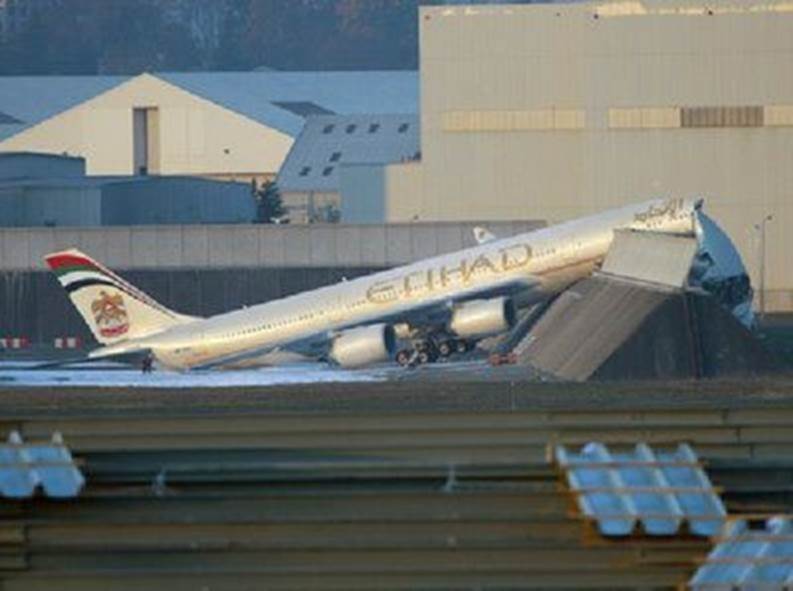

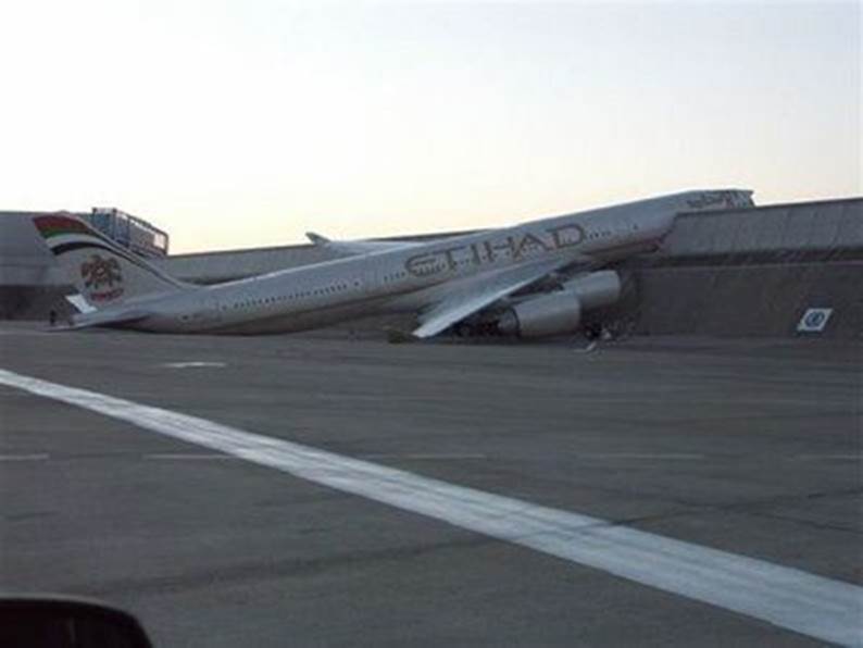

This brand spanking new Airbus 340-600, one of the largest passenger aircraft ever built, sits just outside its hangar in Toulouse , France without a single hour of airtime.
The flight crew of Abu Dhabi Aircraft Technologies (ADAT) entered to conduct pre-delivery tests on the ground, such as engine run-ups, prior to delivery to Etihad Airways.
The ADAT crew taxied the A340-600 to the run-up area, then they took all four engines to take-off power. Perhaps they didn't realise just how light an empty A340-600 really is.
The aircraft computers thought they were trying to take-off because they had all four engines at full power, but the plane wasn't configured properly (flaps/slats, etc..) so a warning horn was blaring away ...
One of the ADAT crew pulled the circuit breaker on the Ground Proximity Sensor to silence the alarm. This fooled the aircraft into thinking it was in the air. The computers automatically released all the brakes which set the aircraft rocketing forward.

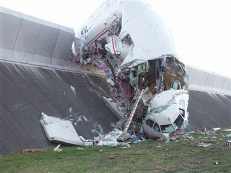

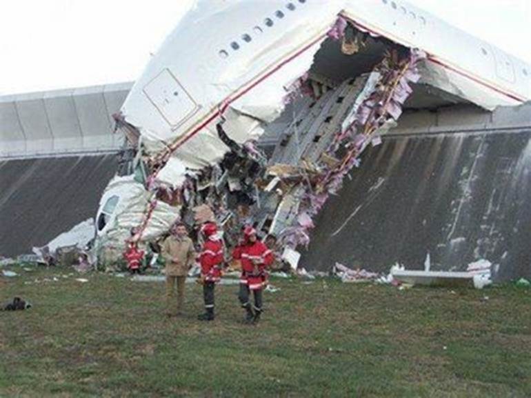

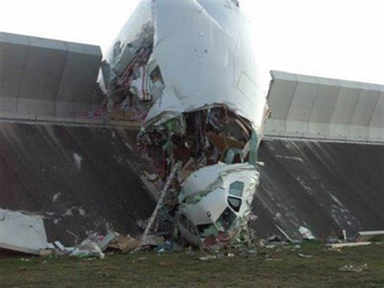

The ADAT crew didn't know that this is a safety feature so that pilots can't land with the brakes on. The crew quickly throttled the engines back from their max power setting but the fans had so much stored energy that they continued to produce thrust for a few moments, so the $200 million brand-new aircraft crashed into a blast barrier, totalling it.

This occurred several years ago when an Ethiad ferry crew went to pick the aircraft up at the Airbus factory. Whilst performing ground engine runs an annoying alarm keep coming up, so they pulled the offending circut-breaker to silence the alarm.
What the alarm was trying to tell them is that you can't go to full power on the ground, in a non- loaded Airbus. Basically they hadn't read or headed the aircraft's operation manual.
After pulling the breaker they again went to full power, whereas the computer said "oh we must be flying now" and promptly released the brakes !.............resulting in the aircraft impacting the barrier. Airbus placed a blanket media ban on the incident as did the airline, for as stated..."possible negative kickback onto the Arab crew"..........................Maj....

The incident did occur but not exactly as described in the numerous email stories which have continued circulating ever since
It was an Airbus technician who was in charge of the test, no circuit breakers were pulled & there was no media blackout
There is a translation of the BEA accident report here - http://www.pprune.org/4705627-post484.html

Read the report, I take back the OK bit, but they are still low-hour engines.
#3 has a few more hours than the rest - it ran for 7 hours after the accident (until it ran out of fuel).
I can tell you that ain't true! You can always apply TOGA thrust (full thrust) on an Airbus on the ground at any weight. The alarm would be telling them they have thrust on with the park brake still set (takeoff config warning), but it certainly won't release the brakes for you.
Not quite sure what possessed Richard DC to say the details in the article are "essentially correct" unless he'd consumed a bit much red wine. They don't make much sense on a number of counts. The BEA report makes sense though, and certainly the photos are genuine.
