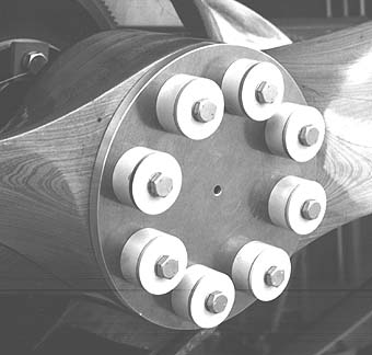

Attached is the wood propeller installation which I designed for a FAR 23 aircraft, which is currently running a Lycoming IO-390 (210 HP/4 cylinder) - tho NOT on the original Lycoming flange. It uses 3 groups of 3 Beleville washers on each bolt - count 'em; that's 72 washers in all. This installation has 20 years of satisfactory operational history, including in Iraq, where the temperature gets to over 50C - and it's working in the hot air outlet of a pusher installation. It does NOT require frequent bolt tension checking. RTFM! One size does NOT fit all!
Beleville washers come in a wide range; if they are specified for your aircraft, make sure you use the correct part number.
The Gipsy installation used - to my recollection - two Beleville washers per bolt; however it is important to NOT tighten Beleville washers sufficiently to fully flatten them; doing so will overstress them and they lose effectiveness. The installation needs to be designed to prevent that.

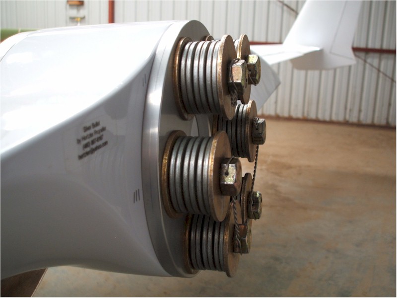

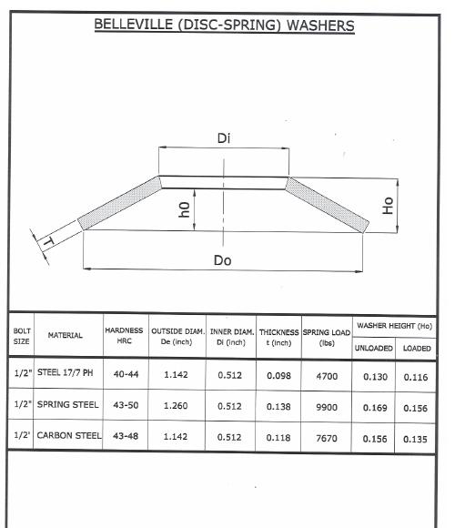

It uses 3 groups of 3 Beleville washers on each bolt - count 'em; that's 72 washers in all.....
Couldn't see any Belleville 1509265455_smilewink.gif.fa04244f48b2dc5aa9eab11d1209ed36.gif washers on that pic, but you can here -
So why does my new Sensenich wooden prop come pre-drilled for spigots?
Presumably because the American manufacturers are used to standard SAE propeller flanges, which are designed for metal props, which use spigots.
Couldn't see any Belleville [ATTACH=full]22952[/ATTACH] washers on that pic, but you can here -[ATTACH]22949[/ATTACH][ATTACH]22950[/ATTACH][ATTACH]22951[/ATTACH]
No, you can't see the Belleville washers on the Seeker installation, because they are inside housings that prevent them from being over-tightened. The arrangement you show gives the maximum accommodation for swelling and shrinkage of the hub, but the smallest clamping force. The arrangement of the washers in the Seeker was
((()))((( because it took 8 lots of three washers in parallel to supply sufficient clamping pressure; and three sets of three washers to give sufficient travel to accommodate the swelling and shrinkage of the hub. One can only work over about 25% of the total compression travel of the washers; tighten them too far & they lose their "spring"; tighten them too little and you do not get sufficient clamping force to drive the propeller. It's a fairly critical piece of engineering design, and each installation has to be treated separately. NOT something to be designed in the backyard.
No, you can't see the Belleville washers on the Seeker installation, because they are inside housings that prevent them from being over-tightened. The arrangement you show gives the maximum accommodation for swelling and shrinkage of the hub, but the smallest clamping force. The arrangement of the washers in the Seeker was((()))((( because it took 8 lots of three washers in parallel to supply sufficient clamping pressure; and three sets of three washers to give sufficient travel to accommodate the swelling and shrinkage of the hub. One can only work over about 25% of the total compression travel of the washers; tighten them too far & they lose their "spring"; tighten them too little and you do not get sufficient clamping force to drive the propeller. It's a fairly critical piece of engineering design, and each installation has to be treated separately. NOT something to be designed in the backyard.

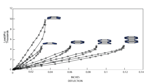

Your comment makes Belleville washers seem like some sort of complex mystery but there's nothing more complicated about designing for the use of them than there is in designing a simple electrical circuit. If you can do the latter in your backyard you can most certainly do the former. All the information for deflection forces and travel limits is available from each supplier of disc-spring (generic) washers so all you need to know is how much clamping force you require and the minimum amount of travel to suit your application, then work out the appropriate series and parallel combination. See typical charts/graphs below.
If you've installed a sleeve over the washers on the Seeker, to prevent over-tightening the washers, doesn't that prevent any expansion movement of the timber/prop plate? Or is the sleeve still loose when the correct force on the washers has been achieved? If you use the sleeve length to determine the compression force then wouldn't you have to fully saturate/humidify the prop at the time of installation and only be using the washers to compensate for prop hub shrinkage?
EDIT - if anyone's interested in the 'deflection' image, right click and 'open in a new tab' or you can't read it.
Your comment makes Belleville washers seem like some sort of complex mystery but there's nothing more complicated about designing for the use of them than there is in designing a simple electrical circuit. If you can do the latter in your backyard you can most certainly do the former. All the information for deflection forces and travel limits is available from each supplier of disc-spring (generic) washers so all you need to know is how much clamping force you require and the minimum amount of travel to suit your application, then work out the appropriate series and parallel combination. See typical charts/graphs below.If you've installed a sleeve over the washers on the Seeker, to prevent over-tightening the washers, doesn't that prevent any expansion movement of the timber/prop plate? Or is the sleeve still loose when the correct force on the washers has been achieved? If you use the sleeve length to determine the compression force then wouldn't you have to fully saturate/humidify the prop at the time of installation and only be using the washers to compensate for prop hub shrinkage?

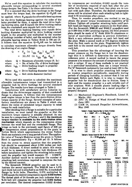

If you read the article by Rose & Bristol - I've managed to upload it, see below - and you know the crushing stress of the propeller timber - you can calculate the maximum torque your flange can transmit, and find the Belleville washer or washers acting in parallel, that give sufficient force at about 75% deflection. Then if you work back down the force curve for the washer, to about 50% deflection, you can calculate the minimum torque. It needs to have about 50% safety margin on the peak instantaneous engine torque, which you can estimate from FAR 23.361 - twice the mean torque, for a four-cylinder engine. If you cannot achieve this margin with the existing flange, the flange is too small. (The flange on the Seeker is considerably larger than the standard SAE flange on the Lycoming).
Then work out the change in thickness of the propeller hub from about 5% moisture content to, say, 18% moisture content, and that will tell you what total travel you need for the washers between 75% deflection and 50% deflection, which will tell you how many groups of washers you need in series to maintain sufficient clamping force over that range of moisture content.
Now, make yourself a little test rig, and test each group of washers - set up as you would place them on a single bolt - to ensure they really do give the force/travel curve you expect from the advertising data - we've found they vary considerably from batch to batch. The test rig will tell you what the compressed length of the stack should be, at the maximum load. The housings need to prevent the pack of washers from being compressed beyond that point. You will also know what the length of the stack will be at half-way between the maximum and the minimum load. That will tell you what the clearance needs to be between the outer part of the housing ("sleeve" as you term it) and the plate that forms the end on the inner part of the housing. You install the propeller using calibrated sets of washers and a feeler gauge.
No, this is NOT rocket science. Anybody who can understand the formula that R & B give, would be capable of doing this. However, I re-derived their formula, and found an error in it. See if you can find it. That's all the free info I'm prepared to supply.

If you read the article by Rose & Bristol - I've managed to upload it, see below - and you know the crushing stress of the propeller timber - you can calculate the maximum torque your flange can transmit, and find the Belleville washer or washers acting in parallel, that give sufficient force at about 75% deflection. Then if you work back down the force curve for the washer, to about 50% deflection, you can calculate the minimum torque. It needs to have about 50% safety margin on the peak instantaneous engine torque, which you can estimate from FAR 23.361 - twice the mean torque, for a four-cylinder engine. If you cannot achieve this margin with the existing flange, the flange is too small. (The flange on the Seeker is considerably larger than the standard SAE flange on the Lycoming).Then work out the change in thickness of the propeller hub from about 5% moisture content to, say, 18% moisture content, and that will tell you what total travel you need for the washers between 75% deflection and 50% deflection, which will tell you how many groups of washers you need in series to maintain sufficient clamping force over that range of moisture content.
