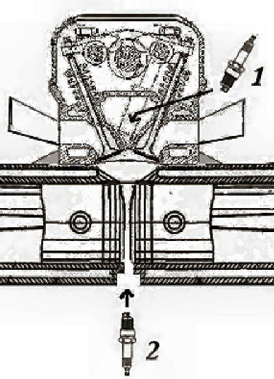

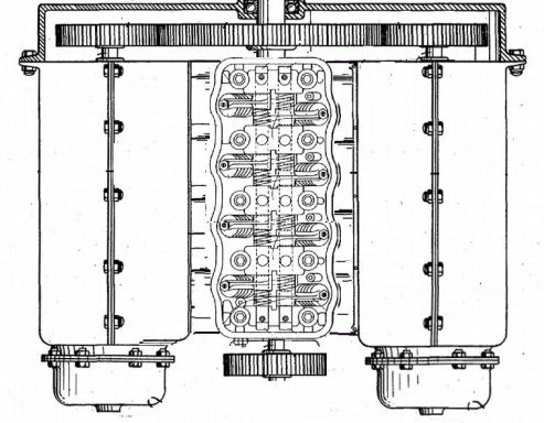

geoffreywh Posted May 30, 2013 Posted May 30, 2013 Wow, now I see the configuration, so cross section-wise, it's going to be "inverted T" sort of. How daring . It looks terrific , inlet and exhaust are very easily planned and so unobtrusive. rocker lube thru' the rocker shaft/s ? ....Symmetrical valve timing too? I've seen that work 20/50/50/20....Dry sump?... Where's the material to take the head bolts? Are you going to have through bolts? ( not a serious question)...sorry for all the questions.. . Congratulations, I hope it's all you design it to be....I'd love to change out my 0-200 for something that actually makes some power...............Another question, looking at your first drawing why does the l/h and r/h "crankcase" not follow the shape of each crankshaft more closely? If the stroke is about 40mm? then i would expect the crank throw and clearance to be no more than 250mm in the vertical plane..Your drawing seems to show it to be bigger than this ( or am I looking at it wrong?) 1

bexrbetter Posted May 30, 2013 Author Posted May 30, 2013 inlet and exhaust are very easily planned and so unobtrusive. rocker lube thru' the rocker shaft/s ? ....Symmetrical valve timing too? Yes, you're seeing the general outlay there ok, that's only a prior art sample by the way and not my actual design but tells the general story. Cam timing and the whole head are simply brand new "off the shelf" heads made in the millions for a historically very reliable engine and that's part of the point of the project, later down the track the engine will be easy and cheap to maintain or repair by anyone with parts available world wide down at your local car parts shops. Dry sump?... Yes, dry sump. Another question, looking at your first drawing why does the l/h and r/h "crankcase" not follow the shape of each crankshaft more closely? Because you are looking at the engine mount end with wide flanges, the other 90% of the engine on the other side of the flanges does follow the crankshaft quite tightly.
facthunter Posted May 30, 2013 Posted May 30, 2013 How are you linking the crankshafts? Gears like a Junkers Jumo? Nev
bexrbetter Posted May 30, 2013 Author Posted May 30, 2013 How are you linking the crankshafts? Gears like a Junkers Jumo? Nev Let me point out clearly that this is a composite prior art drawing for sampling only and used to suggest the design and not the actual design or to scale...
geoffreywh Posted May 30, 2013 Posted May 30, 2013 I did a bit of a search on youtube and the Junkers Jumo seems to be the closest to what you have drawn But with a head planted on the centreline. Looks unique. The Jumo was a very successful engine....Will the cranks rotate in opposite directions? No, too difficult...... I answer my own question. Sorry if I ramble on, I do like a new good design, old world flat fours and sixes are a bit boring....As for a name? How about Wun Tin Lung

bexrbetter Posted May 30, 2013 Author Posted May 30, 2013 I did a bit of a search on youtube and the Junkers Jumo seems to be the closest to what you have drawn But with a head planted on the centreline. Looks unique. Yes but of course like a few others, the Junkers was a 2 stroke. 4 stroke OP engines are very rare in history having no real place or merit in any vehicle until recently when RPM has moved sufficiently high enough to make this layout worth the effort. ..As for a name? How about Wun Tin Lung Looking at the layout I would have thought that would be "Tu Tin Lung"!! 1

damkia Posted May 31, 2013 Posted May 31, 2013 Let me point out clearly that this is a composite prior art drawing for sampling only and used to suggest the design and not the actual design or to scale...[ATTACH=full]22546[/ATTACH] I would have thought you could get away with a simple porting solution (exhaust+/- inlet), rather than go to the trouble of using an OHC head with it's now very awkward shaped combustion chamber... I think you will find that having a center of force from ignition at a significant distance off the line of the pistons themselves is going to cause a few issues, mainly the flame front propagation from ignition causing piston slap (unequal displacement of the upper and lower edges of the piston) leading to galling of the pistons/cyls. The actual bottom of the piston is going to be quite a distance away from the initial ignition and will probably not feel as much of the force of the flame front (cooled by distance and time). One other issue will be a significantly hotter side of the piston/cylinder with all the thermal stress of the OHC head and exhaust concentrated to one side (the old "flat head" problem of cooling the exhaust area). My 2 cents worth for discussion.... 1
eightyknots Posted May 31, 2013 Posted May 31, 2013 I would have thought you could get away with a simple porting solution (exhaust+/- inlet), rather than go to the trouble of using an OHC head with it's now very awkward shaped combustion chamber...I think you will find that having a center of force from ignition at a significant distance off the line of the pistons themselves is going to cause a few issues, mainly the flame front propagation from ignition causing piston slap (unequal displacement of the upper and lower edges of the piston) leading to galling of the pistons/cyls. The actual bottom of the piston is going to be quite a distance away from the initial ignition and will probably not feel as much of the force of the flame front (cooled by distance and time). One other issue will be a significantly hotter side of the piston/cylinder with all the thermal stress of the OHC head and exhaust concentrated to one side (the old "flat head" problem of cooling the exhaust area). My 2 cents worth for discussion.... A bit of (constructive) criticism here: I hope that this won't be a "back to the drawing board" situation.
bexrbetter Posted May 31, 2013 Author Posted May 31, 2013 The actual bottom of the piston is going to be quite a distance away from the initial ignition and will probably not feel as much of the force of the flame front (cooled by distance and time). One other issue will be a significantly hotter side of the piston/cylinder with all the thermal stress of the OHC head and exhaust concentrated to one side (the old "flat head" problem of cooling the exhaust area). My 2 cents worth for discussion.... .... Which might have some significance if I didn't have spark plugs both sides of each cylinder. The whole point is the heads are simply brand new and economical "off the shelf" heads made in the millions for a historically very reliable engine and that's part of the point of the project, later down the track the engine will be easy and cheap to maintain or repair by anyone with parts available world wide down at your local car parts shops. Not only that but more good news, by using these heads, they also have self contained ignition system having a standard distributor bolted into and running off the camshaft and igniting the cylinder head's plugs while a seperate ignition system runs the other plugs, ie; redundent ignition systems at the cheapest cost and simplest method and totally maintainable by the homebuilder. No more being at the mercy of manufacturers with bespoke parts and systems that they take your first born child to pay for. $6000 + parts to rebuild a Jabiru and I have seen $20,000 + parts for Lycoming, what the hell??? Anarchy I say!! 2 1
