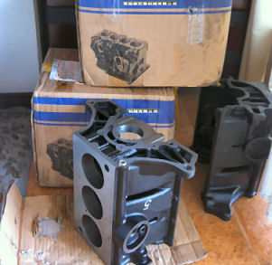

Apparently my cases have been machined and are in transit, maybe tomorrow or Tuesday arrive into my clutches.

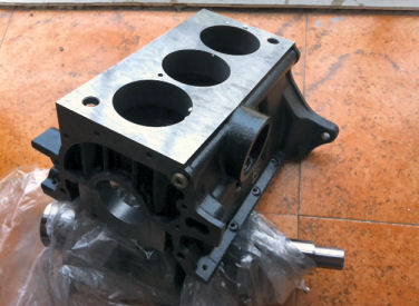

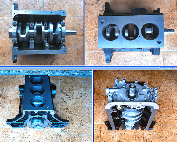

A pair of machined crankshaft housings arrived for me yesterday, bit like Xmas - only I had to pay for the presents 042_hide.gif.f5e8fb1d85d95ffa63d9b5a325bf422e.gif006_laugh.gif.0f7b82c13a0ec29502c5fb56c616f069.gif

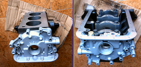

Nice to sit the oil pump housing (front cover) and rear oil seal housing on and see a matched sump surface
Keen eyes will see the deck hieghts were determined by the oiling system, i.e. the front oil pump and main bearing feed gallery (starts where the shiny bungs are in place).
Small things like the OEM alternator bracket pictured that are available 'off the shelf ' help to make this project get to a result.
Later in the week I will throw some main shells in and try out the crank fitment and bore alignment although because it has been machined on OEM machines I would be surprised to see any issues.

Looks great, minimum of excess material, i can't see "head gasket surface?" is there a bit missing that would form combustion chamber?
Yes, all the usual casting lugs seen on an engine have been removed for min. weight, looks and cooling.

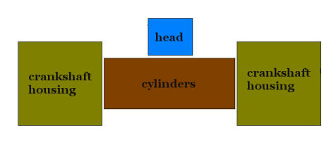

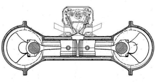

You are only seeing the outer crankshaft housings above and I am now designing the center casings that the head is affixed too and that's why you can't see a head gasket surface! Check the schematic below ...

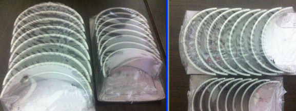

I think you guys are going to like what I did today, walked into my local General Motors spare parts dealer and bought main and big end bearing shells, oil seals, etc. for "normal person" prices. 003_cheezy_grin.gif.c5a94fc2937f61b556d8146a1bc97ef8.gif
That's a better pic with the crank fitted. Great, short stiff crank. Now , the "cylinder " part will acommodate the pistons so will be 2 x stroke + length long with a spigot sticking out at each end....? Have a slot? in the middle to form the combustion chamber, Thats going to be one hell of a "squish" effect! Ingenious. Has this been done before ? Uneven heating might be an issue? Going to look really odd.

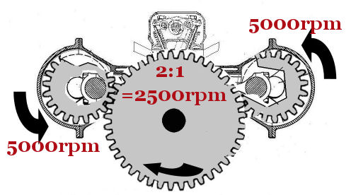

Here's something I wrote about the cranks ..
In the development of the engine over the same time as light aviation, there has been a noticeable change. While the speed of a propeller hasn't changed, lets say 2500rpm is optimal for the moment, engine rpm most certainly has.
Where once an 80hp engine would turn at the same speed as the prop, modern engines are much more efficient turning at much higher speeds, lets use 5000rpm as optimal for the moment and of course are smaller and lighter while doing so.
This difference in speed has required the use of reduction gearing to change the engines optimal speed of 5000rpm to that of the propeller's speed of 2500rpm, i.e. a reduction of 2:1 is required (again example only). This of course can be found on the 80hp class leading engine as standard fitment.
With an OP engine, the 2 crankshafts must be geared together in order to operate in unison and I propose to use the idler gear used to mesh the crankshafts also as the reduction gearing for the propeller as described in this aproximate illustration showing the engine crankshafts turning at 5000rpm and converting that into 2500rpm at the propeller ...
Note that 2:1 is not a practical speed to operate at but this is simplistic explanation.

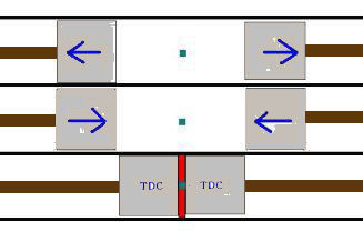

THE ENGINE: The engine concept is quite simple but for a variety of reasons has had no purpose until more modern era. The design is of a twin crankshaft, opposed piston (OP) engine of 3 cylinders which contain a pair of pistons each aiming at each other.
Why: Balance and compact are the main reasons. It's not hard to imagine even for the non-mechanically minded. When you catch a ball you feel the kinetic force strike your hand pushing your hand backwards, now imagine if 2 balls from opposite directions hit your hand at the same time, yes it would hurt, but your hand wouldn't move being pushed back and forward at the same time.
It's similar in an engine, when the piston reaches the top of the cylinder and the crankshaft tries to force it downwards, the piston doesn't want to change direction and tries to lift the crankshaft up with it and the opposite when it reaches the bottom off the cylinder, each time this happens you get a small jolt - this is a very simplistic explanation of what causes primary vibrations in engines and the reason your car has big rubber engine mounts to absorb them even after the manufacturer has designed and balanced the engine to the best of their ability.
In an opposed piston engine such as I am aiming for, the forces created by one side of the engine going one way are equalled by the other side of the engine going in the opposite direction so you have zero jolts, i.e. zero primary vibrations in theory in much reduced secondary vibrations.
Also with the simple layout of a OP, the design allows a standard 'off the shelf' automotive head to be used and as that is the single greatest expense of an engine, costs can be cut dramatically.
So an OP engine with a common automotive head afixed on top will take something like this basic form (sample only, not indicative of actual engine) ...
