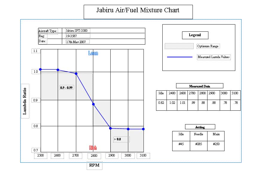

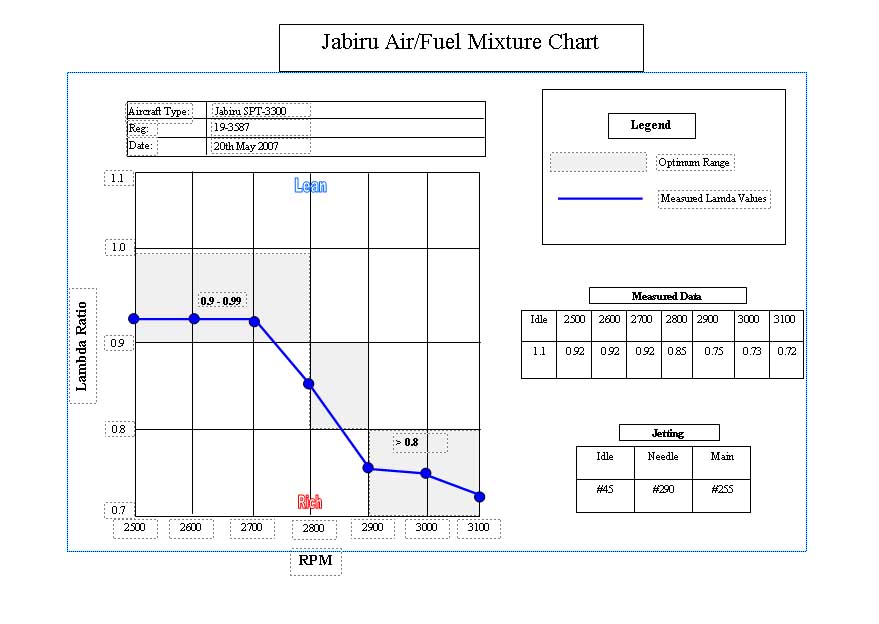

As most of you would be aware, Jabiru have recently released JSL002-2 updating the recommended carby jetting for 2200 & 3300 engines. In the service letter, recommended air/fuel mixture ratios (Lamda) are given for various engine RPM. I decided rather than "play" musical jets, I would purchase a Lambda meter and measure my air/fuel mixture ratios. I made up a proforma using the Jabiru recommended Lamda values as my reference, fitted the Lamda meeter and went flying. Fig 1 shows the readings with the original jetting of 250 Main and 285 Needle jets. (3300 engine) If you look at the graph in fig 1, it shows the engine running lean in cruise. I then fitted the mid range jets as recommended in the Jabiru Service Letter (255 Main & 290 Needle) and the results are shown in fig 2. I now burn 3 l/hr more and find CHT much lower on the ground, in cruise and climb.
Hope this is of some help!

This just highlights a point I have made several times before, do not pusyy foot around by running at low fuel flows.......2600RPM is not the go.
I came back from LRE yesterday, well Rocky in my plane, and I was at 2900 rpm and maybe a touch more and about 23-24LPH in the cruise, and overall average of probably 22LPH.
Drive them how they should be driven. Do not try to cheap scape on fuel burn.

Darryl, for those of us who are not completely up with it, can you give us a more detailed interpretation of the two graphs.
My impression is that Brent should be using at least 22 litres. My 80 HP 912 uses around 17 litres at about 70 percent power. I worry when I see people claiming very low fuel consumption.

David,
Jabiru have produced, through a service letter, the optimum air/fuel mixture ratio for given engine RPM. The two graphs have a grey area which depicts the optimum air/fuel ratio as listed by Jabiru. The first graph shows measurements (blue line) outside the optimum and running too lean. (My original jetting) The second graph shows the blue line inside the grey shaded area after rejetting the carby.
CHEERS
Daryl

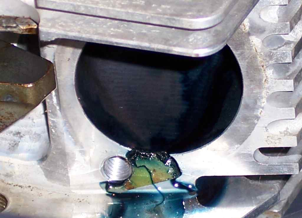

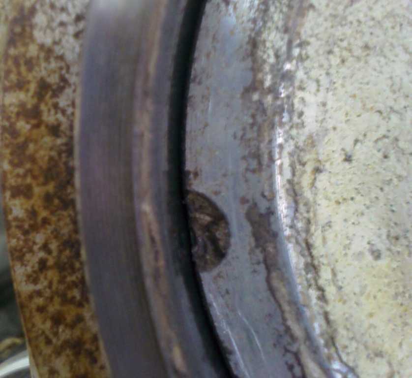

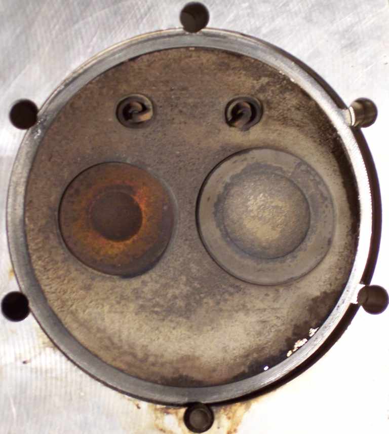

I couldn't wait until next weekend and started to pull off the head on Cyl 1 to try and work out what was wrong. In the end I noticed a couple of things and will post photos of the various bits to illustrate the findings. Some are OK photos, due to the fact that they were done at home with a reasonable point and click digital camera, and the others are the best you can hope for with what the manufacturers optimistically call cameras that fit into phones.
When I pulled the head off the fist thing that struck me was that there appeared to be a problem with the piston. At the prop side (almost exactly) there is an erosion at the edge. There is nothing on the cyl wall to suggest that its a big problem, however I cant see the rings and as such I semi suspect the expert will want to take of the cyl to have a look, (note that I removed the lead/carbon build up around the eroded area with a screwdriver blade so don't think that its odd that you can see piston surface for an arc of 60 degrees or so around the erosion)
[ATTACH]3168.vB[/ATTACH][ATTACH]3169.vB[/ATTACH]
in any event thats what I want him to do, unless you guys can tell me this is normal. If that occurs, based on the previous conversations that have occurred, the through bolts will be replaced (not reused) as I don't have, and I suspect the expert wont have with him,appropriate NDI equipment to tell me if they are flawed in any way.

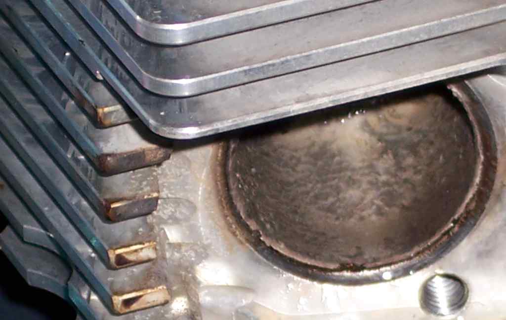

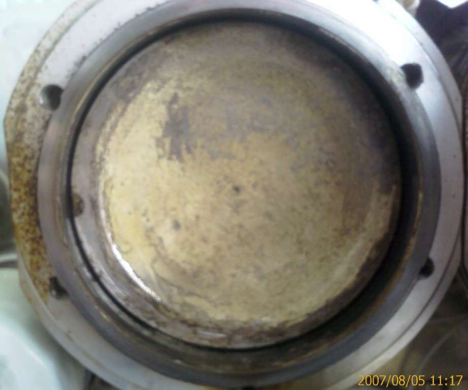

The head didn't show any significant signs of any leakage between head an cyl, though the tensions in the various bolts definitely were not equal.
[ATTACH]3170.vB[/ATTACH]
The valves look OK, and I asked a LAME Sumpie that was at the airfield today how they test and he told me refit the plugs and set so that the head/cyl cavity is facing upward and carefully pour in kero. poor in enough that the valves and plugs are fully covered, but no so much that kero runs down the head bolt holes. If the valves leak the leakage will be evident in the inlet/outlet ports.
[ATTACH]3171.vB[/ATTACH][ATTACH]3172.vB[/ATTACH]
In my head, in both ports kero ended up dripping out so the valves do need to be looked at.
So all in all, perhaps more work than I had first anticipated. A replacement piston, if needed, at 140hrs is a bit rough me thinks.
