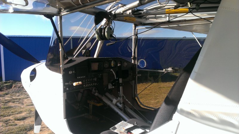

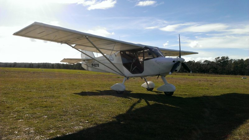

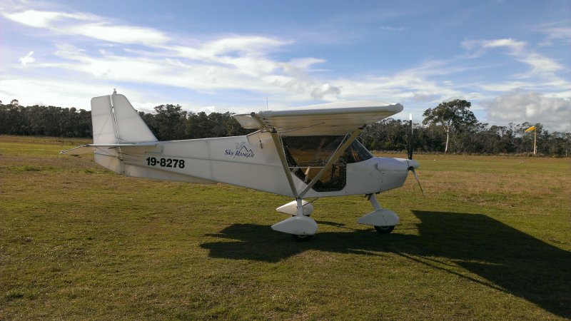

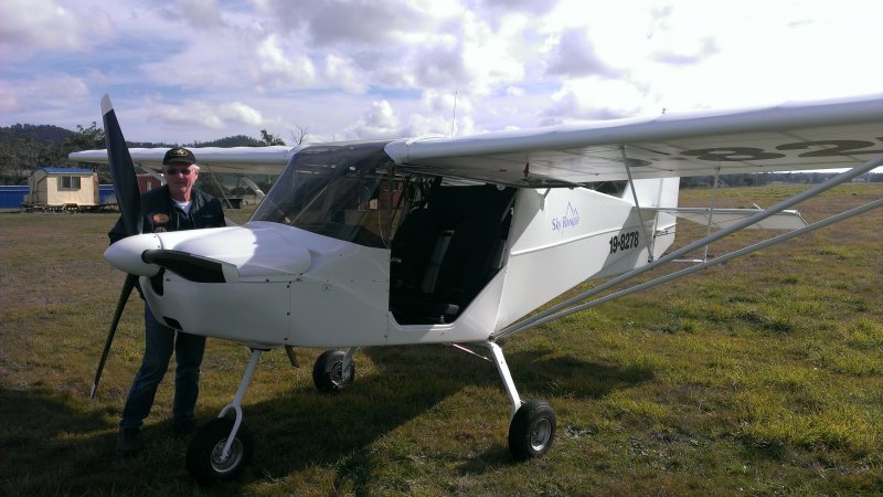

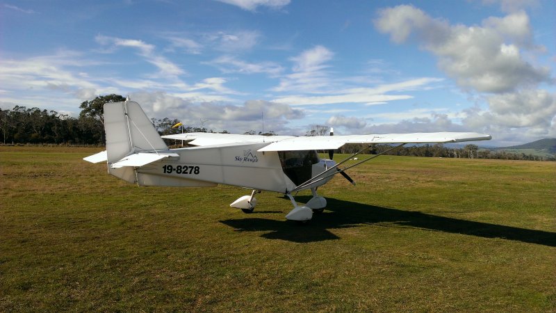

zodiac3813 Posted June 22, 2013 Author Posted June 22, 2013 Thanks Eighty, here are some photos of the (almost) completed project... still have to fit the centre console, connect the AH and compass senders for the MGL EFIS, as well as sort out some minor bugs...
eightyknots Posted June 23, 2013 Posted June 23, 2013 Thanks Eighty, here are some photos of the (almost) completed project... still have to fit the centre console, connect the AH and compass senders for the MGL EFIS, as well as sort out some minor bugs...[ATTACH]22789[/ATTACH][ATTACH]22790[/ATTACH][ATTACH]22791[/ATTACH][ATTACH]22792[/ATTACH] Well done Zodiac! (you'll soon have to ask Ian to rename you Swift3813)
