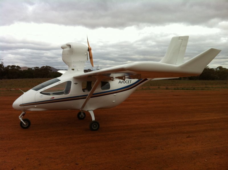

Avocet,what's that plane in your avatar?
That's my Avocet , designed and built by yours truly ,check put the thread "Avocet flys again"
WOW. well done, based on a jab kit? are they cargo doors in the rear? just making a cup of tea and will search for the thread, bloody insomnia!!! teach me for falling asleep on the lounge at 5 only to wake at 11 pm ready for work lol. long night ahead I think

That's my Avocet , designed and built by yours truly ,check put the thread "Avocet flys again "[ATTACH=full]22800[/ATTACH]

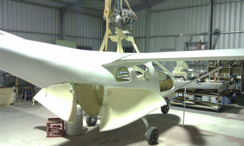

Cargo doors open up , clam shell
Jaby wings 250 made the winglets , fuse,vertical stab. Has duel sticks , centre throttle ,sky view ,
3300 liquid cooled multipoint injection ,and fuel injected throttle body , 30 amp altinator mounted from the vac. spline , jaby alt as backup 62" prop ,cruise 105 kts.
I had to make 25 moulds for the fuse ect.ect
Flys great , easy to land .
It looks like a Catalina when it lands .
Hope to make an amphibious version soon
Ill be flying to aust fly in September at narromine
Cheers Mike

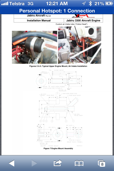

Mike, Jetjr , sorry in my early morning insomnia I forgot to add the page and figure number for the link, page 38 figure 42 shows the male to the rear: http://www.jabiru.net.au/Manuals/Engine/JEM3302-4_Inst.pdf
At odds with the construction manual page 3:
http://www.jabiru.net.au/Manuals/Airframe%20Construction/Sections/Pre-Paint_Fuselage_Firewall_Fit%20engine%20and%20mount_J2400.pdf

I dont think you would end up in court if some one had an accident and the engineount rubber was found to be a t odds with at least one version of the jab manual ,
I'm not talking about any thing else ,
I have at 4 or 5 versions of the jab manuals , even a color hard copy , you could write a book with all the discrepancys in them.
Putting the top rubber around the other way makes it less likely to fail in survice , and hence more safe ,it's a well known practice in jab circles , the ones I move in anyway .

The manuals i use are current and are downloaded from the website every-time there is a change. I received an email today from Jabiru thanking us for pointing out the error in the maintenance publications and warranting some new rubber mounts for both aeroplanes. I understand what you are saying avocet and when i noted that the rubbers seemed soft after installation i rang jab who not only stated that they were made softer but also confirmed the orientation of the male rubbers going on the mount first and confirmed the torque numbers i had ( it was a friday arvo) suspect the gent may have been looking at the same incorrect installation manual as I. Unfortunately i cannot just fit the rubbers the way they used to go, and I am sure you would testify, jab change things all the time in response to a defect or other trigger! this is one of the reasons i must comply with the book and ensure it is kept up to date with any amendments. The LSA regs are black and white as are the regs governing my conduct as an l2 and LAME, N-ot aimed at you but for clarity if you fit a component the way you've always done it without reference to the latest pub's you are playing russian roulette, you may get away with it for a long time but eventually it will catch you out especially if its a procedural change to stop unseen damage caused by the way it used to be done.
