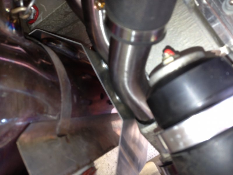

deadstick Posted June 23, 2013 Author Posted June 23, 2013 Here's a defect from the weekend, happened to my aircraft was on it test flight post new engine install. After installing the 3300 I noticed that the rubbers were quite soft and allowed a bit more movement of the engine so I rang Jab who informed me that the compound of the rubbers was recently softened to reduce vibration. End result after 0.6!!!! 1
motzartmerv Posted June 23, 2013 Posted June 23, 2013 Yep, another aircraft U/S.. Thanx jab. This aeroplane has been out fof the air for 6 and 1/2 months while we waited for the back log of engines to clear.. Now we have to wait for new mounts. Make of it what you will, but brand new components have failed in our aircraft 4 times in the last 18 months. Our last defect report instigated an AD re the starter solenoid. No worries Jab, keep sending us your rubbish to test for you. I better shut up before the jab bashing accusations start flying. 1
geoffreywh Posted June 23, 2013 Posted June 23, 2013 That rubber does not look right ..............it's a real shame, they can be so good. But not straight out of the box....David's J230 circumnavigates Australia without missing a beat...Someone I spoke to today mentioned that a new 6 cyl. has solid lifters. (hooray) aircooled motor clearances (at last) pressure fed rockers ( so they should have) and various other "updates"...........go figure
AVOCET Posted June 23, 2013 Posted June 23, 2013 Here's a defect from the weekend, happened to my aircraft was on it test flight post new engine install. After installing the 3300 I noticed that the rubbers were quite soft and allowed a bit more movement of the engine so I rang Jab who informed me that the compound of the rubbers was recently softened to reduce vibration. End result after 0.6!!!! You've got the rubbers the wrong way round , the male should be at the front so the load pushes against the "male bit " The thrust on the female rubber just pushes it out of shape . Cheers . Mike Also , have the male facing forward on the top mount and at the back on the bottom , I've found this works ok .
jetjr Posted June 23, 2013 Posted June 23, 2013 Pretty sure avocet is right. Its in the manual like he says
AVOCET Posted June 23, 2013 Posted June 23, 2013 Pretty sure avocet is right. Its in the manual like he says When I lived in bundaberg I was at jabiru fitting up the first 6cyl sp 6 ( the one that was stolen in WA ) engine with the soft rubbers , and rod stiff was watching and we both noticed the soft rubbers deforming , We then tried reversing the top rubber and it worked ok , I have also from time to time put an hose clamp around the offending rubber , that works ok to and you get the advantage of the soft rubbers , The hard rubbers are available but they do transfer vibration ,. Cheers Mike
motzartmerv Posted June 23, 2013 Posted June 23, 2013 Ok, well according to the current maint manual, on the Jabiru website. Instillation of 3300 engine page 10, it clearly shows the male rubber at the rear. Should we get Rod to amend his maint manual to reflect this 'observation' he made?
motzartmerv Posted June 23, 2013 Posted June 23, 2013 The constructors manual has the mounts inserted male to the front as you guys have described. We cant maintain a school aircraft on a 'constructors' manual, only the instillation and maintenance manuals which clearly show the reverse. This is bloody ridiculous!!!!!Apparently Rods observations made their way to one manual, but not the 'legal' manual that any L2 stating "IAW jabiru maint manual" has to use. Stand back and let the professionalism just whaft over you... 1
deadstick Posted June 23, 2013 Author Posted June 23, 2013 Avocet, Jetjr, Thanks for the info guys, I spoke with someone at jab on the day about configuration as I was concerned with the amount of movement, they confirmed to me the male to the back and gave me the torque figure for the bolts of around 11nm IIRC and stated that the rubbers were being made softer now days for vibe reduction, The Jabiru aircraft tech manual is extremely vague on the install of these mounts here's what I used in conjunction with the info from Jab link page 10: http://www.jabiru.net.au/Manuals/Engine/JEM3302-4_Inst.pdf Since your info here I dug a little further and went into the airframe construction book for the J240 and found this (page 3): http://www.jabiru.net.au/Manuals/Airframe%20Construction/Sections/Pre-Paint_Fuselage_Firewall_Fit%20engine%20and%20mount_J2400.pdf Thanks again for the info I will be amending the defect report for the 230 to include this discrepancy, on the J 170 though, the picture attached is of the lower mount on the J170 it is starting to do the same, going by either reference it is installed correctly, could the rubber be too soft or something else? ideas??? Motz: I had a chuckle when reading your comment, I understand your frustration and sympathise. Looks like a case misinformation on the correct configuration lol... Think Jab should have this clearly set out in the LSA tech manuals and not hidden in the construction log for a home built.

AVOCET Posted June 23, 2013 Posted June 23, 2013 Commonsence trumps porly written manuals All I'm saying is if you put the top mount rubber male facing backwards it works great Take the inissutive , less stress Cheers
motzartmerv Posted June 23, 2013 Posted June 23, 2013 could the rubber be too soft or something else? ideas??? I have an idea... 1
deadstick Posted June 23, 2013 Author Posted June 23, 2013 lol smashing the computer does nothing, I tried it once!!!!
motzartmerv Posted June 23, 2013 Posted June 23, 2013 Commonsence trumps porly written manualsAll I'm saying is if you put the top mount rubber male facing backwards it works great Take the inissutive , less stress Cheers Yes mate, unfortunately, we must maintain IAW with these poorly written manuals when we use the aircraft for hire and reward. The laws are not poorly written and not ambiguous in this regard. "yes your honor, I took the initiative" :)
AVOCET Posted June 23, 2013 Posted June 23, 2013 Yes mate, unfortunately, we must maintain IAW with these poorly written manuals when we use the aircraft for hire and reward. The laws are not poorly written and not ambiguous in this regard. "yes your honor, I took the initiative" :) Your kidding right ,? Gong to court for putting the engine mount in the right way ? Cheers Mike
