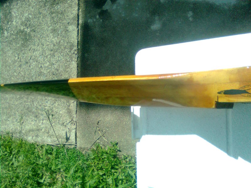

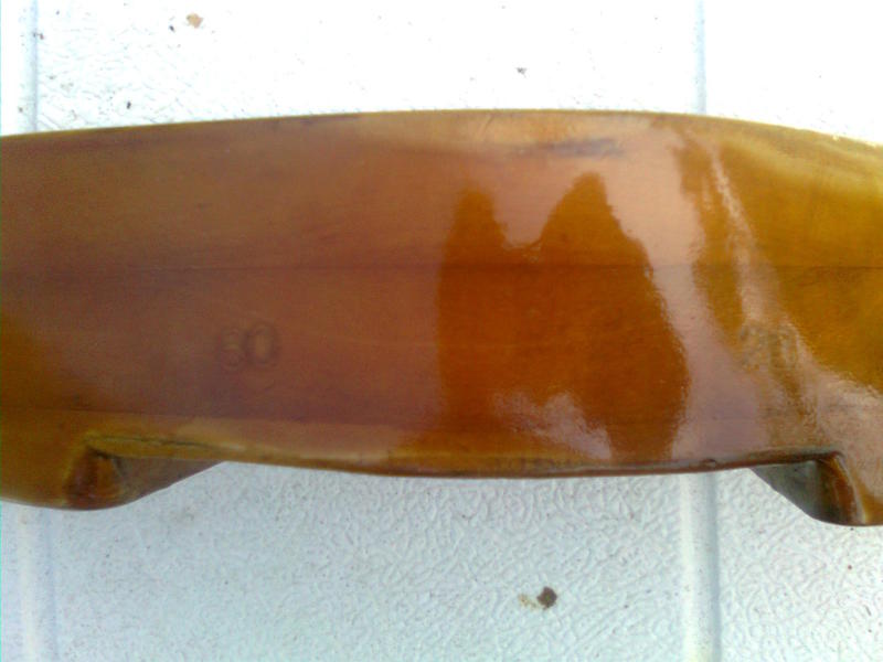

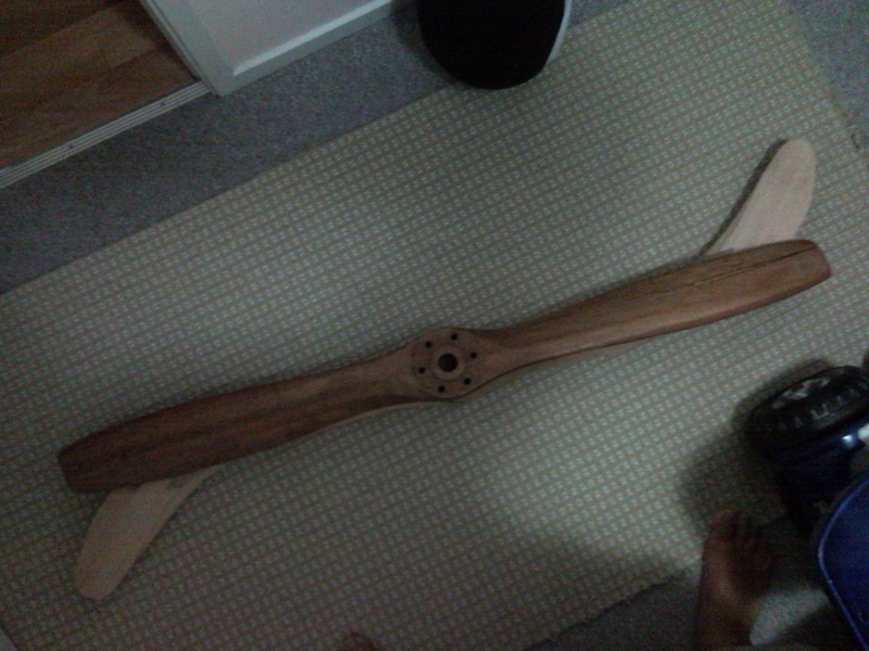

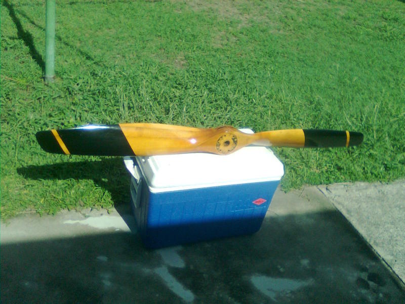

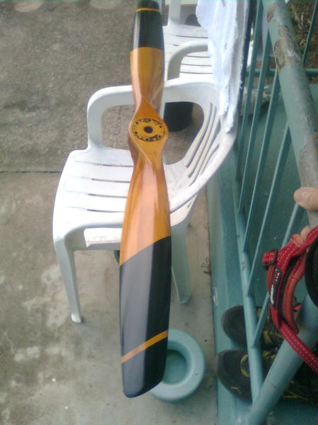

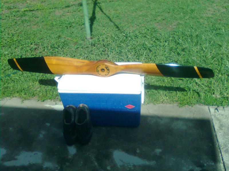

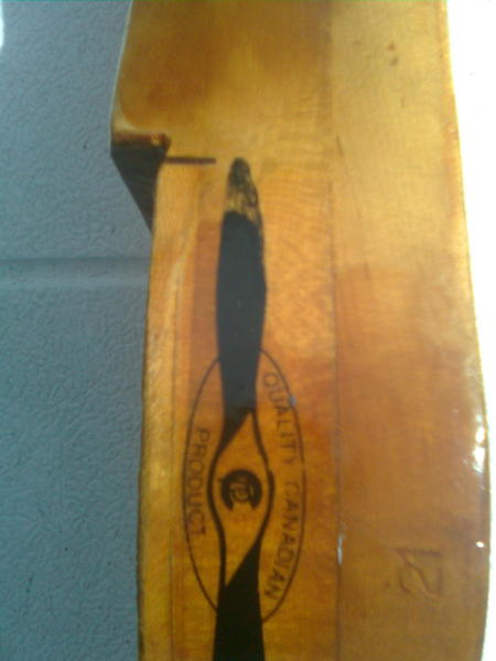

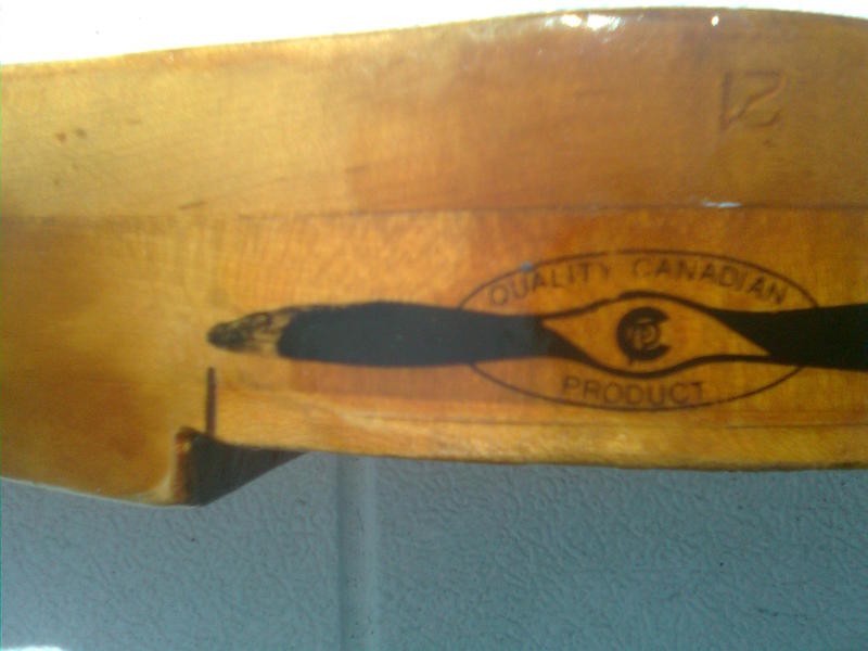

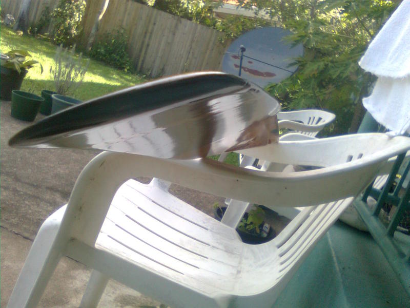

Ok, Sorry for the delay but I can now post photos of the prop mentioned in posts 1 & 6. This is the prop used on the Hirth F23. It was originally a canadian product of unknown brand and stamped 60 x 28. It is additionally stamped on the other side 21...which i may have done after cutting the prop down. i was pretty good with my pitch calculations back then using recommended formulas and this may have been the effective pitch that i came up with. The prop length now is 54 ". So it is now a 54 x 21. Although some take-off were less than inspiring, I did do many hours of quality flying behind this prop, once off the ground, and up and running.
