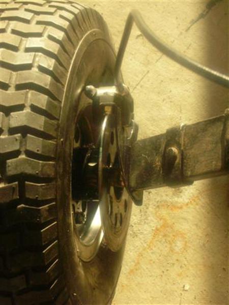

Thruster87 Posted June 2, 2007 Author Posted June 2, 2007 My new disc brake setup [ATTACH]2217[/ATTACH]

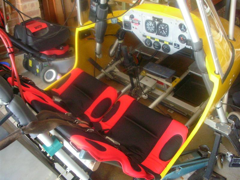

Guest fly Posted June 13, 2007 Posted June 13, 2007 Hi Alan From my point of view pictures of your rig are just what I want, or any other thrusters pics I am rebuilding a T500 and have little material to refer to . just the interior of the pod layout, instrument panel, battery location up front , trolley jack under passengers seat!!! was all great . more please. Thanks .........FLY
Guest Juliette Lima Posted June 14, 2007 Posted June 14, 2007 Hi Thruster 87, Having aircraft mods/innovations in specific aircraft type segments sounds great.... Care to post re. your new disc brake setup....where, how, cost/benefits etc.?...are threse the ones recently advertised in the Pacific Flyer ? Incidently, what type of tyres are you using ? Thanks in anticipation JL
Thruster87 Posted June 14, 2007 Author Posted June 14, 2007 Howdy, I used Hayes HD hydraulic disc brakes[cost $225.00 ]but had to change one line as it was only 90cm long [front brake] to 125cm cost $20.00 exchange/fitted/not bled at local bike shop. The 203mm Rotors plus adapters sold on eBay for $90.00 as I made my own 160mm Dia out of 2mm cr mo.Tires are Kings 15.00 x 6.00 2 ply supplied by Steve Vette when he was still in Qld.Looking forward to now putting a NEW 503 on in the next couple of weeks about $5200.00 with B box. Then I'll do the brake testing [seems OK on the jacks]. Cheers
