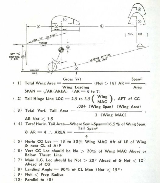

M61A1 Posted December 20, 2012 Posted December 20, 2012 I dont know if this will help in you efforts, it was posted for me on another site, I found it useful. Apparently came from a Boeing design engineer some years ago. 3
Head in the clouds Posted December 20, 2012 Posted December 20, 2012 That's not a bad summation M61. One flaw I spotted is the angles, No 8 says not less than 15* from the datum whereas it should be from the mainplane chordline which would have a fixed incidence of approx 3* so No 8 should say 12* but then even that much can be hard to achieve in many configurations, even making 'mounting the beast' very difficult for some designs and No 10 is virtually impossible to achieve in a tractor design so weaving taxiing becomes the order of the day. Equipping the craft with flaps really helps with the No 8 static angle allowing a further reduction of at least 3* without risk of banging the tailwheel on before the mains in a full stall landing. No 5 might be a bit less than conservative but depends on the airfoil, with non-laminar foils I'd stick to max 25% aft CG position until some flight-test data has been collected.
