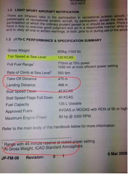

ayavner Posted November 8, 2012 Posted November 8, 2012 Hi there, Hoping someone can jog my memory as to where to get started figuring this out. I have tried googling it, but so far have only come up with some very complicated articles using maths symbols I have never seen, or links to apps to do it for me - I seem to remember having learned this at some point, something to do with calculating pressure and density altitude, but having trouble remembering the connective tissue that ties it into the takeoff and landing distance. POH just shows the distances at ICAO std atmosphere, but say I want to know what it is at 30* and 2500' AMSL? thanks, all help gratefully received :)
Guest Howard Hughes Posted November 8, 2012 Posted November 8, 2012 Can you post a picture of your POH page? Then I can give you some pointers on how to read it!
ayavner Posted November 8, 2012 Author Posted November 8, 2012 Sure thing HH, thanks! there isn't anything in the POH other than this info, so a bit stuck, though I did find something called a Koch chart on the FAA site... Cheers! adam
facthunter Posted November 8, 2012 Posted November 8, 2012 Think you will have trouble deriving figures. Larger planes like a Beaver would probably have a very adequate Graph/chart which will give you a trend but beware of engines that are supercharged that can compensate for power loss due to altitude. You can run into a length limit due to low power and the need to accelerate to a higher actual speed, and a performance (climb) limit due to density altitude. Pretty difficult job I reckon. Nev
ayavner Posted November 8, 2012 Author Posted November 8, 2012 Nope, see what i mean? So what would one reasonably do in this situation, if there is no way to calculate it? I presume "hope for the best" isn't an option

Guest Howard Hughes Posted November 8, 2012 Posted November 8, 2012 Koch chart looks like the way to go. I would be adding at least a 20% buffer to any figure extrapolated from the Koch chart and exercise extreme caution when taking off in hot/high conditions. Do you have the instructions on how to use the chart? You could also employ the 80/50 rule. That is if you have not achieved 80% of your flight speed in 50% of your available take off distance, then abort! PS: Did some searching and found a number of different Jab 17o POH's, with different figures in the performance section!!
