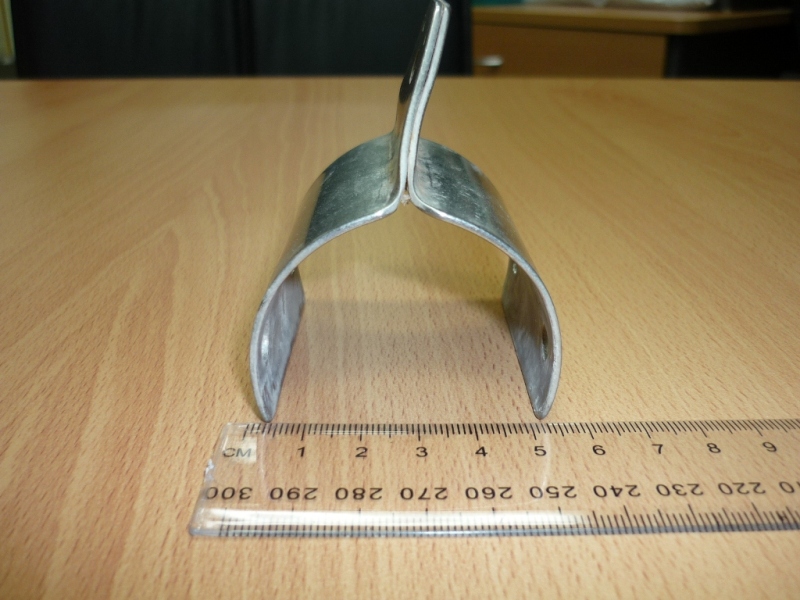

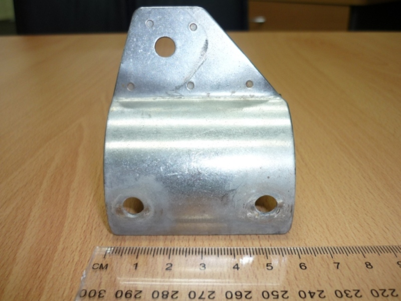

Here's the photos I took into the fabricator. I needed new ones because the old ones had been bent out of shape and I didn't want to chance it by straightening the tang and putting back into service.

Yes never straighten those brackets we have had a fatality with that been done.
Pud the brackets were not welded around the seams, but they did have the sharp fold marks.
