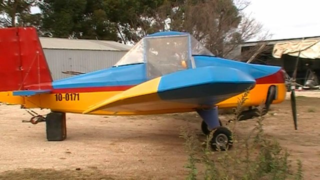

I am curious - is this the Supercat that was advertised on Ebay for a long, long time?
yes and the plane that had engine failure flying it home after 3 hours circut work.(earlier thread)

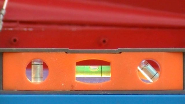

just done a very rough balance on a beem with plane level and 70kgpilot.set beem(1 1/2" thick beam under fuselarge which is flat) at 14"(optimum cg) and it lifted the mains ? looking tail heavy? will move beem tomorrow to find at which point the tail lifts and find where current cg is sitting.

must say from a pilots point of view it feels front heavy.Take off feels normal and balanced,level flight at cruise seems normal but the intant you back off revs she nose over and want to contiue noseing without 3/4 stick,now with revs set 60 kt level I pushed her forward and set approach angle and she still wanted to pitch forward asi now 70...? if not front heavy I would say tail plane,I spent 15 years designing and biulding R.C scale models and if it where a large model doing this and the balance was right I would 1.adjust tail plane (NOT a thrust line issue as it does it throttled back)and check for adequet air flow over them,2 exsteand the tail to main gap and re balance.but she aint a model and I cant stretch her..lol

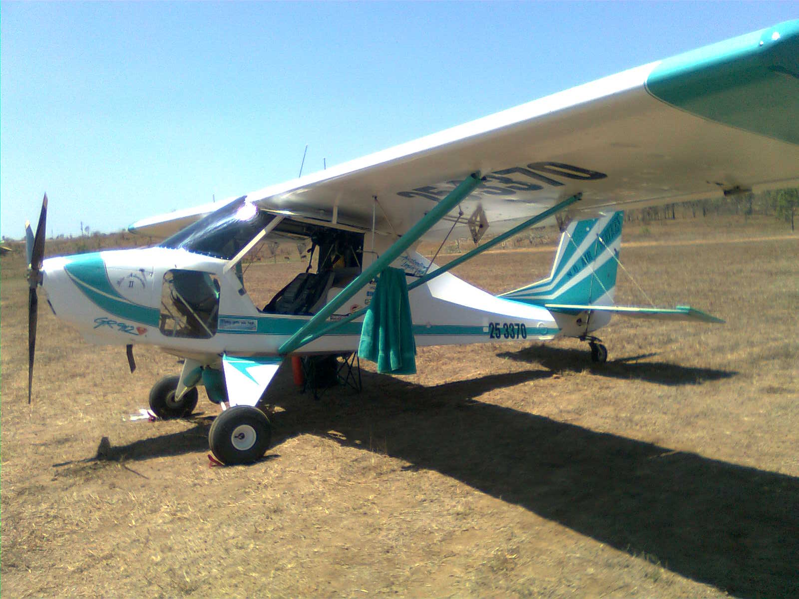

Guest Maj Millard

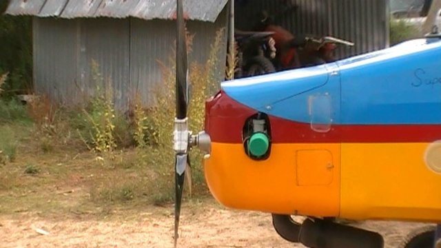

Flyerme, that looks like a Powerfin prop you've got there...happy with it ?.....I've got 650 hours on mine now on the Lightwing and it's going fine....................................................Maj...012_thumb_up.gif.cb3bc51429685855e5e23c55d661406e.gifImage0114.thumb.jpg.9e8ebb1427a5b388c68cc2364bea2384.jpg
fuel moment from prop to centre of tank is 37" 1/2 full=22ltrs full=45 litrs
pilot c.g was taken with me seated, measuered to my belly button from prop
Flyerme, that looks like a Powerfin prop you've got there...happy with it ?.....I've got 650 hours on mine now on the Lightwing and it's going fine....................................................Maj...012_thumb_up.gif.cb3bc51429685855e5e23c55d661406e.gif[ATTACH=full]17360[/ATTACH]
wow thats an awesome looking lighty,,,,I would def say the best i've seen, and yeh love the power fin,very smooth,easily ground adjust,very very forgiving on gravel and such ,love it.. mine has been cut down from 60" to 56",NOT sure why? but no complaints with da prop
