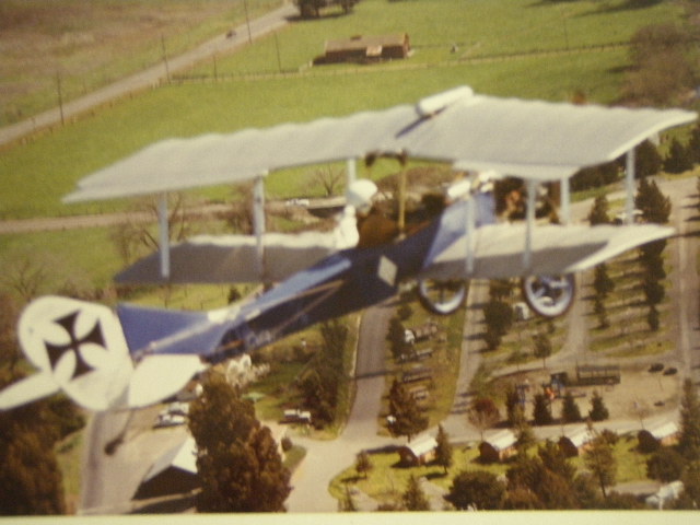

Guest Maj Millard Posted April 28, 2012 Posted April 28, 2012 You'll have to include about 3/4 fuel and yourself to get an accurate static CG by hanging, that's the hard part, getting everything set up and finally climbing in yourself. You can of course substitute weight for the pilot, but the hang must be done as it would be flown, for an accurate static balance. I did a hanging static CG originally when I built my biplane, and had no dramas with CG in flight at all. The GC of the aircraft (flying) must always remain just fwd of the wing center of pressure which moves back and forth as the wing AOA changes. On some airfoil types the center of pressure moves more than others. At the high AOA at the stall point the center of pressure has moved foward to it's furthest point, this is where the COG needs to be ahead of it to ensure the nose drops through.....................................................Maj...
flyerme Posted April 28, 2012 Author Posted April 28, 2012 [ATTACH=full]17338[/ATTACH]You'll have to include about 3/4 fuel and yourself to get an accurate static CG by hanging, that's the hard part, getting everything set up and finally climbing in yourself. You can of course substitute weight for the pilot, but the hang must be done as it would be flown, for an accurate static balance. I did a hanging static CG originally when I built my biplane, and had no dramas with CG in flight at all. The GC of the aircraft (flying) must always remain just fwd of the wing center of pressure which moves back and forth as the wing AOA changes. On some airfoil types the center of pressure moves more than others. At the high AOA at the stall point the center of pressure has moved foward to it's furthest point, this is where the COG needs to be ahead of it to ensure the nose drops through.....................................................Maj... Hey Maj,how did you hang it?I mean where and how did you fit a sling etc..P.S love the lil bipe,is that a brs on top?
Guest Maj Millard Posted April 28, 2012 Posted April 28, 2012 Well the bipe was easy to hang, there were gaps at the wing roots and I passed a rope down between each wing, and under the fuselage. It doesn't need to hang too high just a few inches above the floor. Don't know how you would hang a Supercat as chances are your static CG will be around the wing somewhere. Final fine adjustment is often done with battery location, or pilot seat adjustments. Strange thing was, as I had mine hanging a local aircraft restorer came in who restored Stearmans and Wacos etc. He was amazed and impressed I was doing it that way, but it sure did work, as the bipe flew just fine.........................................................Maj...
