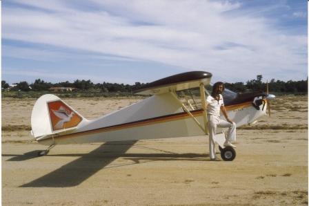

Guernsey Posted April 12, 2012 Posted April 12, 2012 As you know from previous posts I used to own a Supa Pup Mk2 which handled extremely well with very positive controls and was easy to fly, as for performance figures that depends on the engine, mine being a Global 2 cylinder four stroke which was underpowered however I could still cruise at 70 knots. Alan.

Guest nunans Posted April 16, 2012 Posted April 16, 2012 As you know from previous posts I used to own a Supa Pup Mk2 which handled extremely well with very positive controls and was easy to fly, as for performance figures that depends on the engine, mine being a Global 2 cylinder four stroke which was underpowered however I could still cruise at 70 knots.Alan. Great pic Alan (the aircraft looks good too ;) 70 knots with yours! sounds like i've got some work to do, mine is cruising at 60 with the 503 at 6000 or a bit over (2.58:1) so that tells me the pitch on my prop is fairly fine however i only get 5600 rpm static with the same prop so I'm thinking the modified exhaust that has been fitted isn't doing a great job.. My pup is climbing at about 300 feet/min at full throttle so when both the climb and cruise is poor i'm thinking the hp isn't there. The next step is a new stock 503 exhaust and see what the static RPM gets to. Is a 66" two blade prop too big for a 503 with my gearing in this aircraft?
