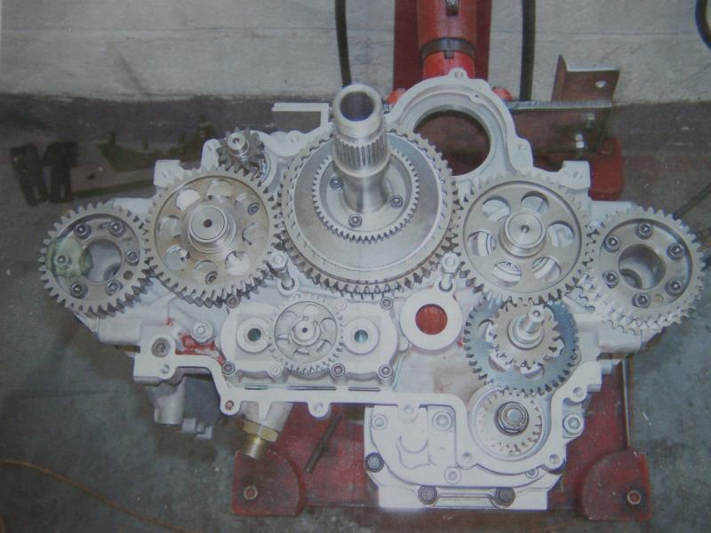

When I was a Oshkosh did see a "Gemini diesel" it looked like a very promising engine quite a considerable amount of modern day metal in the construction, the other interesting point a British development project. I will try and load a photo of the gear end, I found this very interesting.
Send me a message then I can send it to you, I think I need lessons:crying:.
