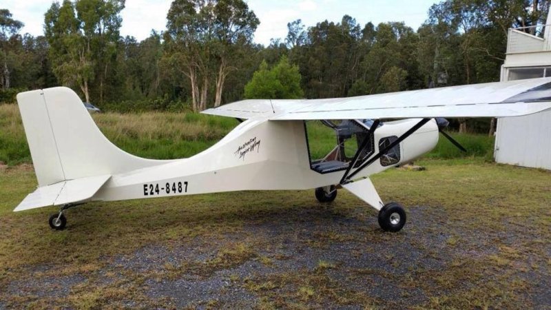

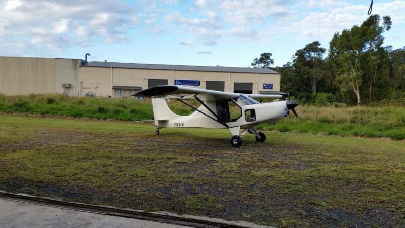

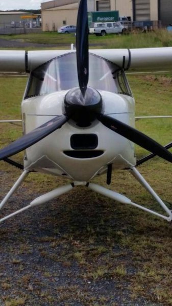

Bob Llewellyn Posted May 16, 2014 Posted May 16, 2014 [ATTACH=full]29001[/ATTACH] [ATTACH=full]29002[/ATTACH] [ATTACH=full]29003[/ATTACH] Well almost done . Nice. touch of Auster, touch of Porter, touch of Maule. Very nice to see an adequate vertical stabiliser for a change... and like the Austers, it's a NACA 230XX airfoil, which should reduce the trim drag and improve the stall speed a tad. 1
Guest Maj Millard Posted May 17, 2014 Posted May 17, 2014 Nice. touch of Auster, touch of Porter, touch of Maule. Very nice to see an adequate vertical stabiliser for a change... and like the Austers, it's a NACA 230XX airfoil, which should reduce the trim drag and improve the stall speed a tad.[/quote Lightwings in my opinion have never suffered from lack of vertical fin surface...or rudder area for that matter. When the 912 was installed both were increased to counteract the increased foward weight and to assure better spin recovery should it be needed. If you have flown as many different Lightwing models as I have you would have noted that without exception all handle very well in an aggressive sideslip manoeuvre which is proof that these surfaces are well and adequetly proportioned, unlike on some other Aussie produced aircraft. The fin change on the new model has been further increased in area because the engine (weight) has also been put further foward. However the main change is in the curving of the surface in lue of the previous angular corners, which you will note was also incorporated into the speed line of aircraft. A curve always looks nicer than an angular change. Howie also knows the value of an aircraft to be able to sideslip well when needed. I feel the area behind the cabin is not as pretty as it could be on the new aircraft, and maybe they should have left it as it was originally flowing straight off the cabin roof. I do like the longer nose look though, and the full- view doors are a winner as I experienced while ferrying a Sport 2000 once with them.......Maj....
Bob Llewellyn Posted May 17, 2014 Posted May 17, 2014 [ATTACH=full]29011[/ATTACH] I was talking in terms of the multiplicity of recreational types - and some GA - with marginal or less VS, not saying this was a great step fowards for Lightwings ... Bill was guided by Bruhn, and Howie was - to some degree - guided by Bill, so all the HW Lightwings represent an intersection of engineering conservatism and practical useability. I am not so much a fan of the long nose, because in the balked landing case such a prop position has a significant deleterious effect on pitch stability - if an aeroplane has the tailfeathers to handle it, it's less efficient than it would be without the hose nose. By eye, and from my limited GR-912T flying, the Lightwing should handle it...
Guest Maj Millard Posted May 17, 2014 Posted May 17, 2014 I do like the clean up on the engine cowl, that should be good for some extra knots. A three blade prop is the way to go. As I said before the full view doors are a winner but from memory can't be open in flight like the original ones. With the prop further fwd stability in all axis should be enhanced. The Lightwing needs to be bought up into the 90 kt cruise range, the proper wing change would do it....not sure if they have done it on this one. This paint job is not that complimentary either..........but nice to see another new model emerge........Maj.......
Bob Llewellyn Posted May 18, 2014 Posted May 18, 2014 I do like the clean up on the engine cowl, that should be good for some extra knots. A three blade prop is the way to go. As I said before the full view doors are a winner but from memory can't be open in flight like the original ones. With the prop further fwd stability in all axis should be enhanced. The Lightwing needs to be bought up into the 90 kt cruise range, the proper wing change would do it....not sure if they have done it on this one. This paint job is not that complimentary either..........but nice to see another new model emerge........Maj....... It's actually quite a challenge to achieve a cruise speed of twice the stall speed, due to the induced drag going up as the 4th power of the speed coming down - that is, in order to have enough wing to be able to climb when close to stall speed, one has too much wing to go fast on low power. The limited speed range of fixed pitch propellors also challenges the top end... 1
jeffd Posted May 22, 2014 Posted May 22, 2014 The Lightwings underwent a bit of design evolution before they got to the GR912 / GR912T (and perhaps even slightly in the earliest of those).Because of Howie's determination to get crashworthiness into the structure, and Bill Whitney's (legendary) approach to structures, the Lightwing family have significant reserves of strength. This does not mean that just any Lightwing should be taken to 600kg! - the reserves generally aren't that big. They were forced into the - rather unjustified - weight and stall speed limitations of CAO 95:25, then CAO 101:55, which is where the 1000lb (450kg) / 1,200lb (544kg) and 40kts come from. Lightwing have the build records, and would therefore be able - if they wanted - to determine the MTOW to which each airframe could be justified, outside of CAO 101:55. I suspect that the knowledge gained with the Speed, is being applied to achieving an improved LSA GR-912 evolution; but Lightwings are NOT all identical, and only the factory can determine which pre-existing aircraft could safely be lifted to 600kg TOW - if any. The "new" one should be a fairly useful aeroplane. ive been in aircraft with both those designations however i didnt find no beer ?
alf jessup Posted May 23, 2014 Posted May 23, 2014 [ATTACH=full]29011[/ATTACH] Hate to say it Maj, but the old model like yours and Doug's have much nicer lines, something just doesn't look right on the empennage compared to your models. Awesome though that Lightwing have re -introduced the model again. I guess beauty is in the eye of the beholder, new model just doesn't cut it for me. Alf 4
Bob Llewellyn Posted May 24, 2014 Posted May 24, 2014 ive been in aircraft with both those designations however i didnt find no beer ? I think HHE drink all their beer for safety purposes...
pylon500 Posted May 30, 2014 Posted May 30, 2014 I'm just worried the long nose is to help with a weight problem down the back? It is starting to grow on me....
