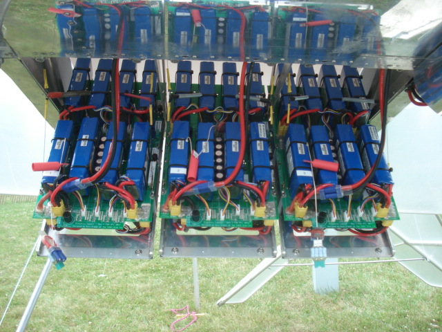

DSC03375.JPG.d132db93ba684719362445ef6ae57794.JPG Litespeed i think this set up is brilliant. The battery packs are mounted to circuit boards and are easily removable and are stored on the CoG in the wing. They are pretty much out of harms way both for the batteries and the pilot. A thermal blanket protects the upper and lower surfaces. They just swing down and remove in seconds. The wing mounting is great for the twin engine design giving very short cable run. The concept can easily be used in front of the firewall for single engine as well. I think as electric kicks in we will see many different concepts.

Ozzie,
I like that setup in the pic- what is it from?
It looks like the chargers are integrated below the cells, I assume the controller is next to the engine.
Thermal barriers are a definite plus for safety.

This is from Dale Kramer's E Lazair that was at AV this year, more photos here http://www.recreationalflying.com/useralbums/electric-lazair.31/view
There is also a photo of the charger set up there is one for each side.
The controller is mounted in a tunnel on the underside on the motor nacelles
if you are interested in how he did it here is the link http://www.rcgroups.com/forums/showthread.php?t=1412424
but it will take 3 hours at least to read it all.
