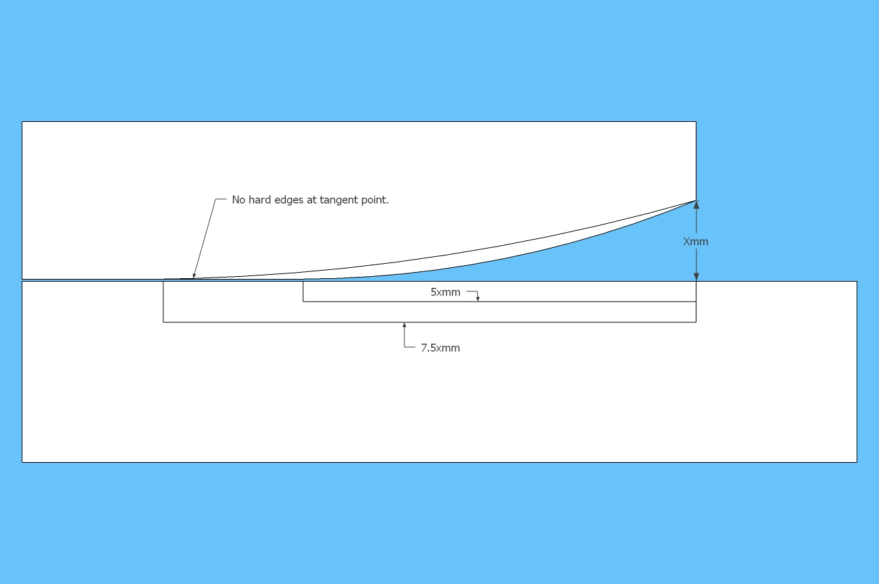

Old Koreelah Posted September 6, 2011 Posted September 6, 2011 I seek advice about connecting two aircraft grade aluminium tubes which will serve as the leading edge of my flaps. For simplicity and added strength, I am making the flaps in one piece, so the connected tubes will be 4.5m long. At the centre the overlapping sleeve, about 500mm long, will be both glued and riveted over the tubes it is joining. It will also take most of the torque loads from the flap actuating lever. I have the material ready to do the job and feel that it may be wise to avoid a rigid strong point at the overlap, in case it leads to stress fractures. The two obvious solutions are shown in the attached picture; to "bevel" the very thin outer tube at the join, or (my preference) to "scollop" the edge with smooth curves, so that a single stress line cannot develop. Any suggestions? Lyle [ATTACH]14970[/ATTACH]

rgmwa Posted September 7, 2011 Posted September 7, 2011 Haven't seen the photo, but understand that you want to avoid a sharp transition in stiffness at the end of the sleeve. Best would probably be a long taper but as the material is thin, the taper would be very short. My suggestion, and that's all it is, would be to consider cutting a series of equally spaced V's (like deep serrations - maybe 20mm deep?) with rounded and deburred ends and `valleys'. and with an internal angle of around 20-30deg. This will transition the stiffness over the 20mm length. rgmwa 1

Deskpilot Posted September 12, 2011 Posted September 12, 2011 Lyle, to make an informed decision we need to know the tube diameters and wall thicknesses.
Old Koreelah Posted September 12, 2011 Author Posted September 12, 2011 Lyle, to make an informed decision we need to know the tube diameters and wall thicknesses. Thanks, DP, the tubes are 2024T3; the inner is 1.5'' dia. with 0.035" wall; the outer is 1+7/8" with 0.35" wall.
Deskpilot Posted September 12, 2011 Posted September 12, 2011 Lyle, you sure they're the correct sizes? 0.35" is a pretty thick wall thickness. Almost 10mm, and there's going to be a pretty big clearance twix the 2 tubes.
pudestcon Posted September 12, 2011 Posted September 12, 2011 Lyle, you sure they're the correct sizes? 0.35" is a pretty thick wall thickness. Almost 10mm, and there's going to be a pretty big clearance twix the 2 tubes. try 0.035" dp, I reckon a typo is involved eh?
Pilot Pete Posted September 12, 2011 Posted September 12, 2011 Why not slip a piece of solid material in the smaller tube,slide the larger over and fix with 2 bolts 90 deg apart.
Deskpilot Posted September 12, 2011 Posted September 12, 2011 Bolt or rivet, you need a sliding fit for a good mechanical join. This means, no slop, but then no pressure needed to push the 2 together either. The sizes you are giving leave way too much play to form a sound joint and therefore the rounding or tapering the inner surfaces of the outer tube are a mute point at this stage. For what it's worth, I would opt for a gradual arc bringing the wall thickness to about half it's original size and being about 10/15 times as long as it's reduction size. Does that make sense? eg. a 0.5mm reduction in wall thickness over a length of 5 to 7.5 mm. Just make sure there are no hard edges at the start point inside the tube. This will become a wear point if any.
Old Koreelah Posted September 12, 2011 Author Posted September 12, 2011 Lyle, you sure they're the correct sizes? 0.35" is a pretty thick wall thickness. Almost 10mm, and there's going to be a pretty big clearance twix the 2 tubes. Sorry for the typo DP, the tubes are 2024T3; the inner is 1.5'' dia. with 0.035" wall; the outer is 1+7/8" with 0.049" wall. (Gawd I don't understand these archaic measurements; give me a few microns any day...)
Deskpilot Posted September 12, 2011 Posted September 12, 2011 I hope I'm wrong but I've calculated a 3.5(179)mm gap all round your inner tube. I'd suggest you look for something around 0.5mm Although I was raised in the UK with Imperial measurements, it is a damn sight easier to use the metric system.
Old Koreelah Posted September 12, 2011 Author Posted September 12, 2011 I hope I'm wrong but I've calculated a 3.5(179)mm gap all round your inner tube. I'd suggest you look for something around 0.5mmAlthough I was raised in the UK with Imperial measurements, it is a damn sight easier to use the metric system. Thanks DP, I learned both metric and imperial in a little rural NSW school in the 1950's- must have had a forward-thinking teacher! I already have the two tubes, and the larger one fits pretty snugly over the long inner tube, with just enough space for some epoxy metal glue. I have not been able to upload my pix, so a description: If the ends of the overlapping sleeve are straight, then I fear a stress line could be established. If I "scallop" the ends of the outer joining sleeve tube to a continuous S-shape it should distribute stresses over a larger area. Any comments welcome.
pudestcon Posted September 12, 2011 Posted September 12, 2011 Would I be correct in surmising that the stresses on the leading edge of your flaps here would not be that great, and therefore the stress line you speak of OK would be minimal? I imagine most forces acting on this component would be torsional, therefore the fixings (bolts and/or rivets?) would be taking most of the load, and that in shear. Pud
Old Koreelah Posted September 12, 2011 Author Posted September 12, 2011 Would I be correct in surmising that the stresses on the leading edge of your flaps here would not be that great, and therefore the stress line you speak of OK would be minimal? I imagine most forces acting on this component would be torsional, therefore the fixings (bolts and/or rivets?) would be taking most of the load, and that in shear.Pud Yes Pud, that sound right. With hinge-points offset like a Jab, the flap is rotated thru about 37° and also pushed and pulled thru an arc by two actuating rods inside the fuselage.
Old Koreelah Posted September 12, 2011 Author Posted September 12, 2011 Bolt or rivet, you need a sliding fit for a good mechanical join. This means, no slop, but then no pressure needed to push the 2 together either. The sizes you are giving leave way too much play to form a sound joint and therefore the rounding or tapering the inner surfaces of the outer tube are a mute point at this stage. For what it's worth, I would opt for a gradual arc bringing the wall thickness to about half it's original size and being about 10/15 times as long as it's reduction size. Does that make sense? eg. a 0.5mm reduction in wall thickness over a length of 5 to 7.5 mm. Just make sure there are no hard edges at the start point inside the tube. This will become a wear point if any.[ATTACH=full]14989[/ATTACH] Thanks, DP, that's interesting and makes sense having the outer sleeve taper away from the inner one.
