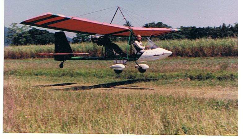

When I built my Chinook, I had no plans or drawings, nothing!... Just an aircraft to look at and copy from and a burning desire to succeed!..I made most of the parts by hand!...I powered it with a Fuji Robin 440 engine!
The local sail maker was supposed to make up the skins for me, but when it came time, he didn`t want to do it anymore, so I reckoned!... If he can do it, so can I!... So I did and over the years,I`ve made 3 sets for the Drifter also!
The guy who`s aircraft I copied from and was an experienced pilot, was supposed to test fly mine for me!... when the time came!... You guesed it!... So i did it myself!
I learnt a lot and gained an enormous sense of achievement and satisfaction!
It`s not the way to go for everyone,but it realy was the way for me!
That`s me in the Drifter!
Frank.
