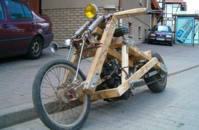

Here is a picture of an African home-built motorbike (I'm not sure from which publication they got the plans from). blink.gif.7ee21b69ed31ab2b1903acc52ec4cc3f.gif
[ATTACH=full]19867[/ATTACH]Good advice OME.
I believe this was the original prototype for the more advanced African model.
