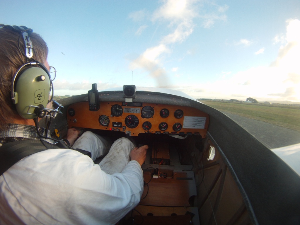

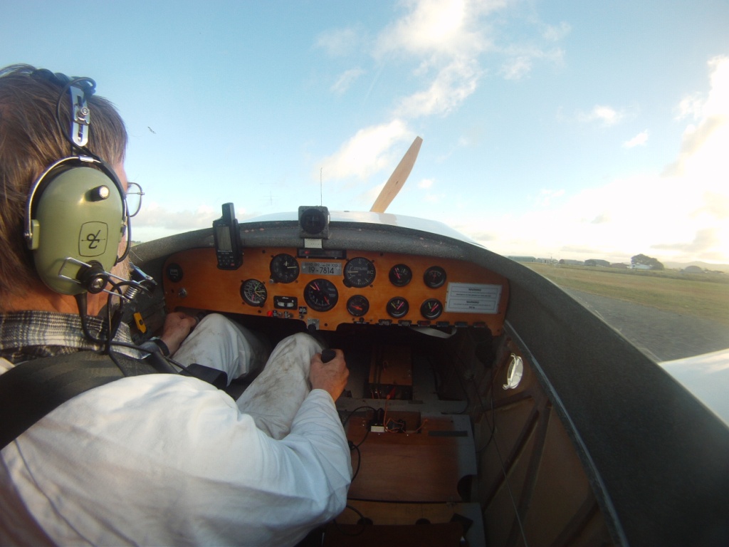

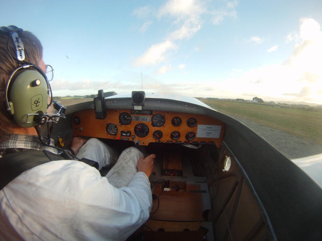

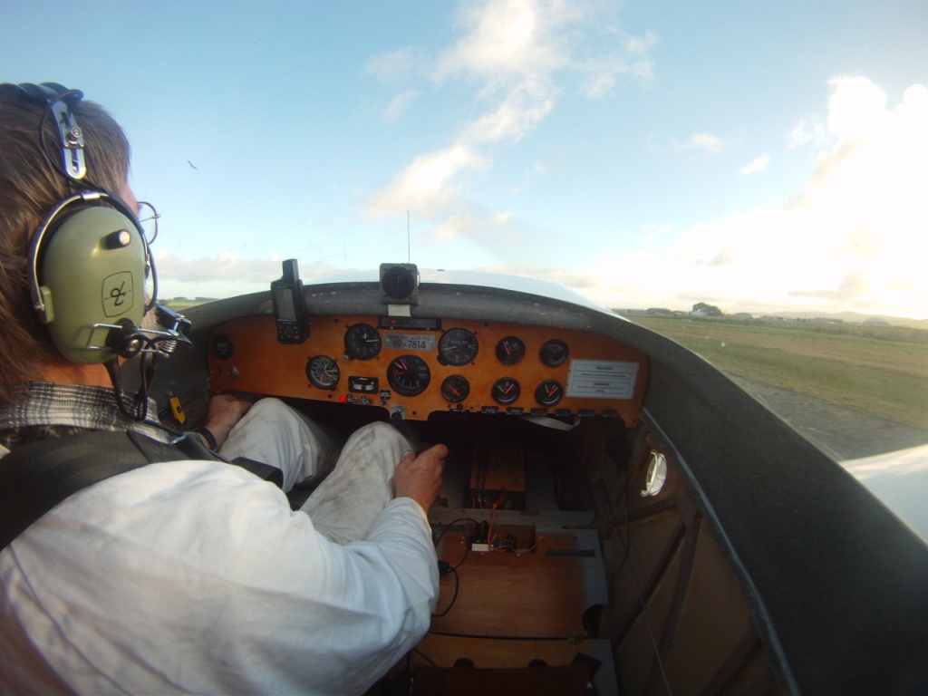

Then we went for some tail up runs and found a bit of a problem .... every time (almost) that I lifted the tail, the engine cut out. See the attached sequence of photos taken by a camera we setup to take photos every 5 seconds for just this sort of issue .... the resolution is a bit fuzzy to reduce the size, but on the originals you can read the instruments fairly well too ....
From the indications on the mixture indicator (the row of LEDs top centre of the panel (lean =red to the left, rich orange to the right)) the mixture goes lean as the tail comes up and then the engine stops, all in less than 15 seconds ...... this is just one of several sequences we recorded all much the same ...
Would appreciate any wisdom as she ain't gonna fly 'till I find out why .... and fix it!

Hmm what engine? but off chance i'd might lean toward incorrect float level and or poor fuel pressure.
Not much point in guessing. Unhook your fuel feed pipe near the carb. lift the tail and see whether you get air ot nothing at all and then trace your fuel run back to the tank. Are you running a booster pump? So far you get the most unusual fuel problem award. Nev

Check fuel line is not being kinked anywhere. Could it be related to stick position rather than pitch attitude? The level of the carbs should not be that fussy. If it was the acceleration on T/O would be a consideration also. Needs to be sorted, thoroughly...Nev
How's the fuel suction in the tank?
Like Nev said the carby shouldn't be that sensitive! Unless the carby has been touched previously, I think your problem is somewhere else - ie, fuel supply.
By the way, does it stop like you've switched the key off, or does it hesitate?
Could something in the tank be moving across the inlet, when the tail come up. I would definitely try a fuel flow test with the tail raised. I was once stopped in a car by an ignition coil that was loose and moving, it shorted out on acceleration, then came back on.
