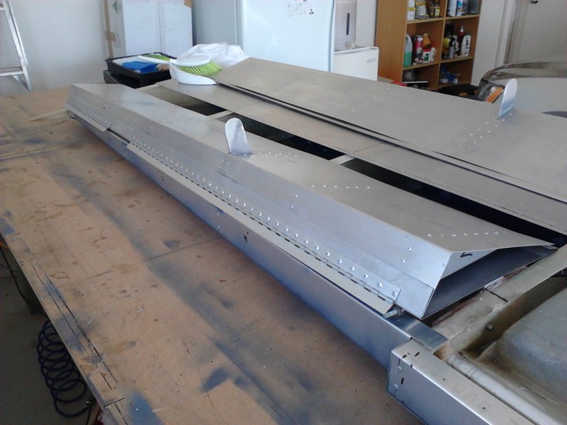

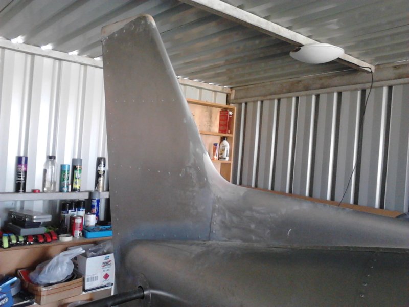

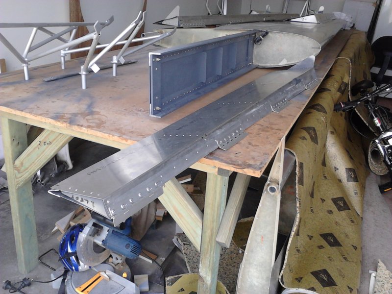

kgwilson Posted April 3, 2013 Author Posted April 3, 2013 Its a while since I posted anything. I have completed the ailerons and flaps and installed the hinges on them but these will not be installed on the wings until I have the aircraft fully assembled & the wings set to the correct dihedral & the main bolts installed. I've been busy with other things in March so not much was achieved although I ordered the engine and have arranged for everything to get to the airfield. The engine was delivered today & the fuselage & wings should be there tomorrow so the process of assembly and all the important and fiddly bits begins. Just to prove it is underway attached are pics of the flaps & ailerons & the trailer packed & ready to go. 1
silvercity Posted April 3, 2013 Posted April 3, 2013 Its a while since I posted anything. I have completed the ailerons and flaps and installed the hinges on them but these will not be installed on the wings until I have the aircraft fully assembled & the wings set to the correct dihedral & the main bolts installed.I've been busy with other things in March so not much was achieved although I ordered the engine and have arranged for everything to get to the airfield. The engine was delivered today & the fuselage & wings should be there tomorrow so the process of assembly and all the important and fiddly bits begins. Just to prove it is underway attached are pics of the flaps & ailerons & the trailer packed & ready to go.[ATTACH]21420[/ATTACH] [ATTACH]21421[/ATTACH] [ATTACH]21422[/ATTACH] Looking good Kevin ... how would you rate the degree of build difficulty and overall quality of the kit?
kgwilson Posted April 4, 2013 Author Posted April 4, 2013 Looking good Kevin ... how would you rate the degree of build difficulty and overall quality of the kit? The kit is all good quality 6061 T6 Aluminium, American sheet, all AN aircraft nuts & bolts etc. Can't compare to other kits as I haven't built any thing else. Its not like a Savannah kit with CNC machined bits & pre-drilled rivet holes. There are a few preformed bits but mostly you bend, cut, drill & shape everything. The fibreglass mouldings are good & just need trimming & finishing. I picked my kit up & it took about 3 days to work out what was what. If you have some engineering knowledge & can follow the plans & the manual, plus photos & the construction video, build difficulty is not too bad. Garry or Tim Morgan are always available for advice when you get stuck so after sales service is ongoing.

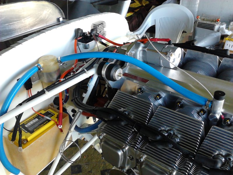

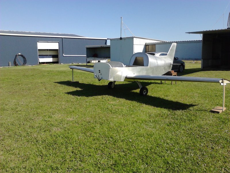

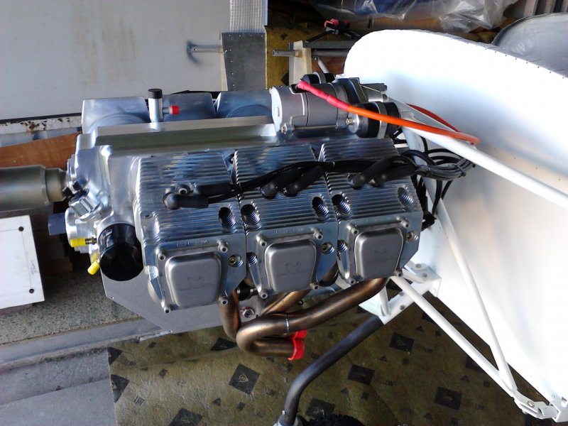

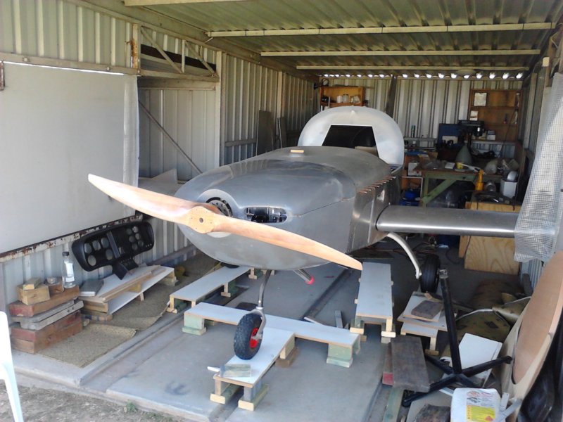

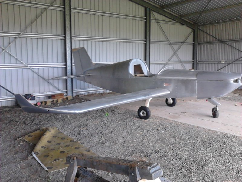

kgwilson Posted June 15, 2013 Author Posted June 15, 2013 It seems to have taken forever but I have finally got the wings on and fitted the main bolts, locating pins and drag spar bolts. Then I took them off again as I need to build a 100 mm high ramp to get the aircraft into the T Hangar or re-model the hangar into a full size one. I plan to extend the hangar but finishing the build is priority 1. I have installed the engine mount and managed to get the engine installed yesterday. It was a bit fiddly but with a borrowed engine hoist it all worked out well. Next I'll get all the wiring, battery, cables & fuel lines, airbox, oil cooler & other cooling bits done, install the centre tank and forward deck, instrument panel & instruments & then I might build a ramp or re-build the hangar. I forgot to take a photo after I'd bolted the wings in place so this is one with the supports before levelling etc in the big hangar on the left. 1

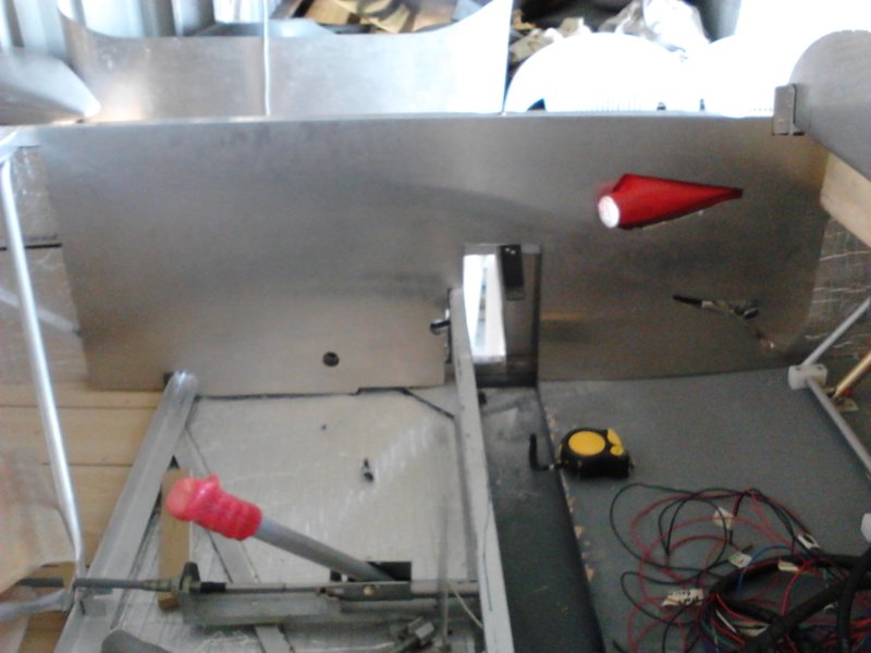

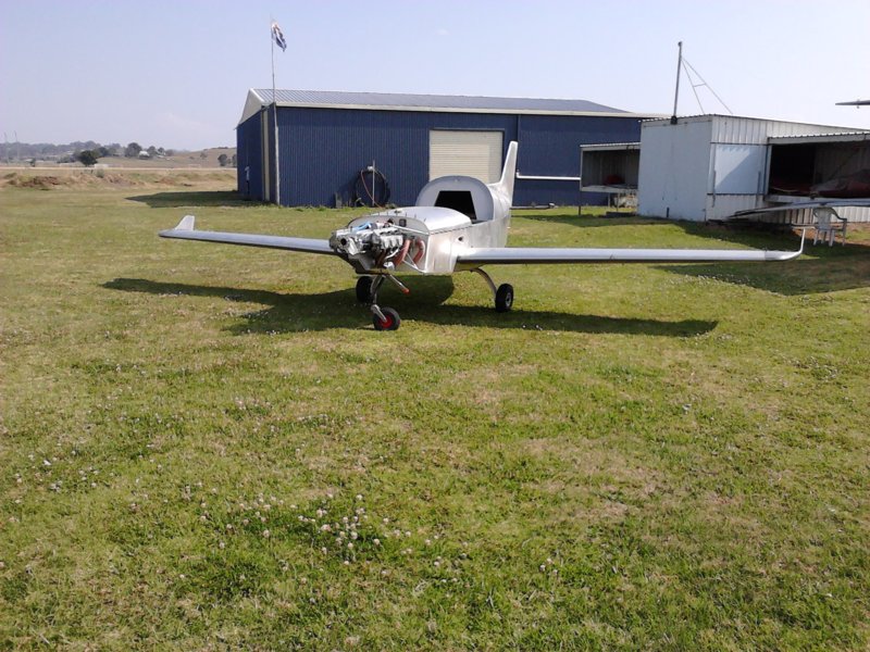

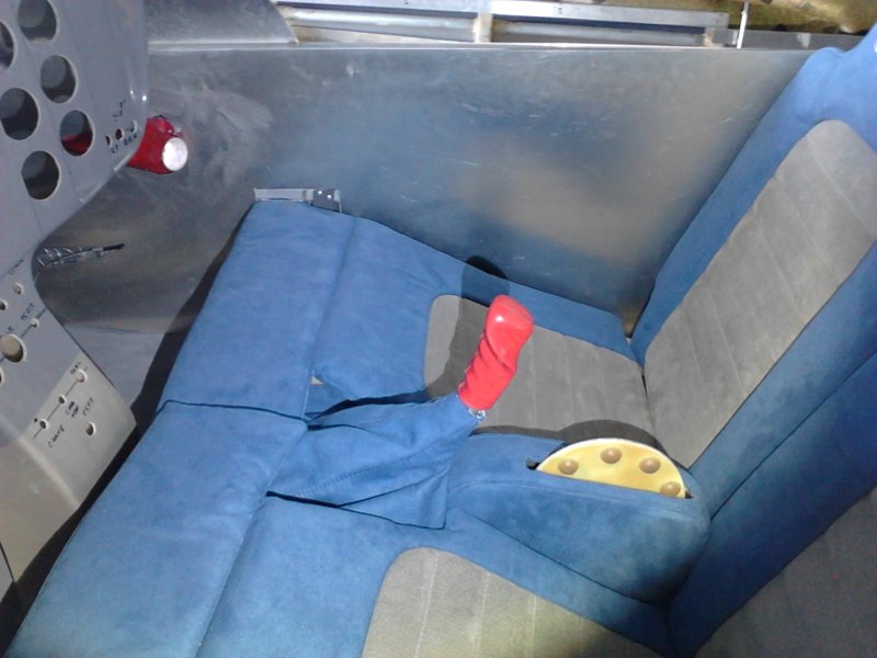

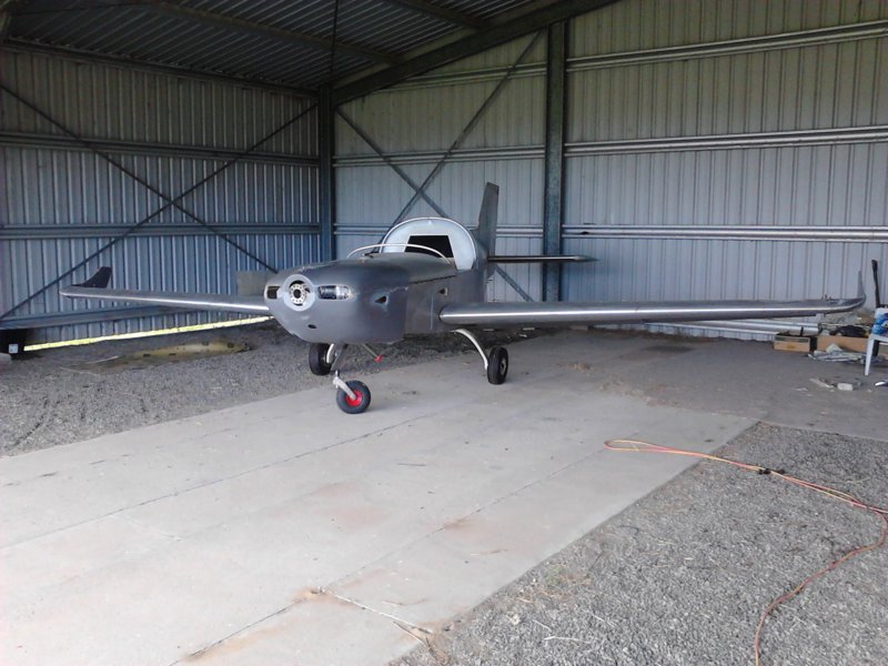

kgwilson Posted November 3, 2013 Author Posted November 3, 2013 4 months since my last update. Anyway I have wired the engine & loom back to the panel, installed the cobra head, airbox, carb heat etc, put carb temp, EGT & CHT probes in, put an inspection hatch in at the tail to check & service the stabilator bell crank, installed the interior metal lining, (to be upholstered) installed the cabin air NACA ducts, pre-fitted the instruments & panel, installed the flaps & ailerons, installed the winglet tips, installed the cowling & added a few cosmetics like a curved fillet between the dorsal & tail fin. Still need to glass in the carb air intake NACA duct & oil cooler duct. next is the canopy, paint, interior fitout, brakes & wheel spats Rego & testing. There will be a bit of a delay while I rebuild the hangar. A few progress pics attached

kgwilson Posted July 10, 2014 Author Posted July 10, 2014 Very nice so far Kevin.How many hours do you have in this build so far? Total hours to date is 791. Due to other issues like building my hangar & refurbishing our Aero clubhouse I have only put in 22 hours this calendar year. The plane is ready to paint once I have fitted the canopy & installed the pitot tube & static. The panel has been done & removed but there is still cabin wiring & upholstery installation etc once painting is done. The last work was done in April but my Hangar is almost finished so I'll be back into it soon. These are the last photos taken in April in the borrowed hangar.

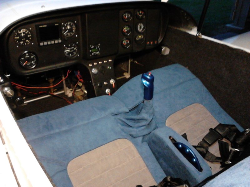

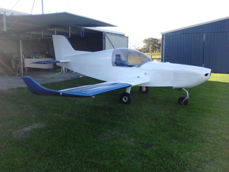

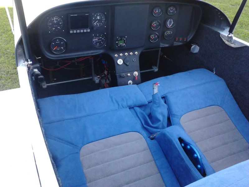

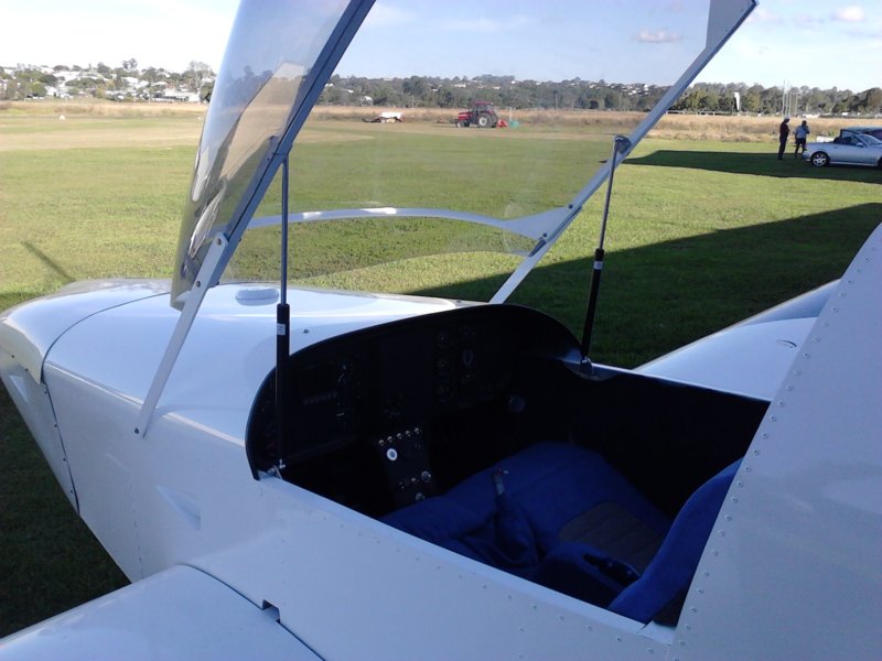

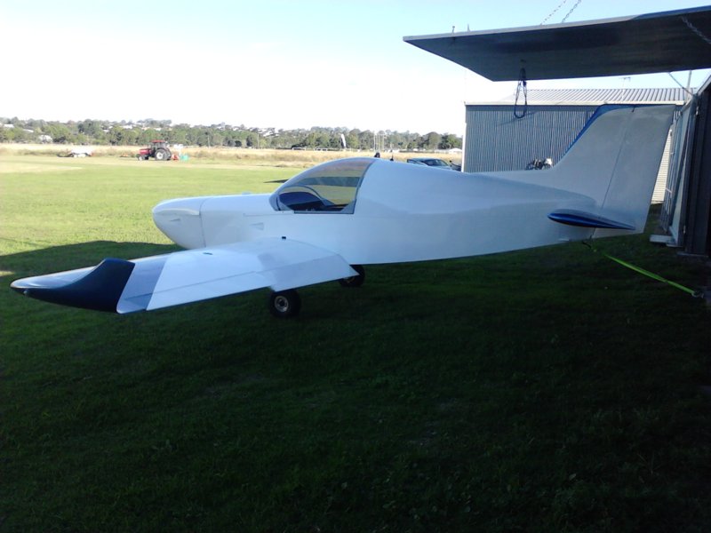

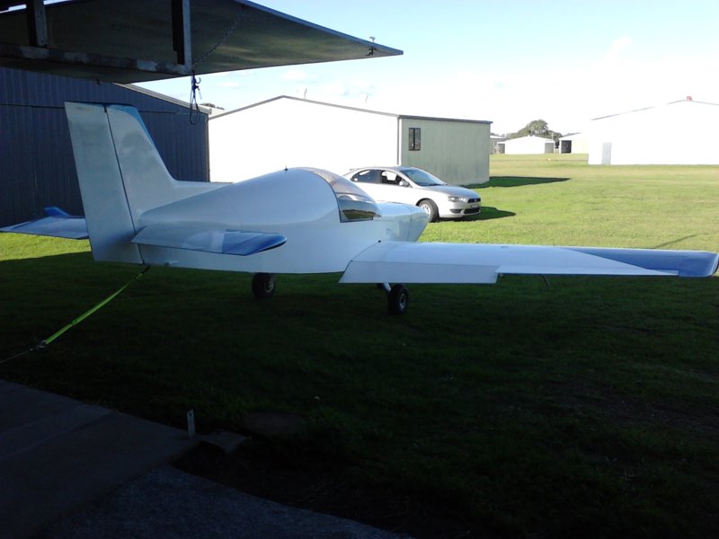

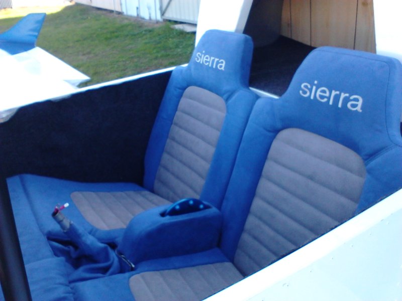

kgwilson Posted May 30, 2015 Author Posted May 30, 2015 It is 4 years today since I started this thread and my Sierra is almost ready. After being 90% complete seemingly forever the final 90% is about 80% done. I decided that I wanted to do everything & that included painting so I bought myself a HVLP spray gun set & taught myself to spray paint, initially on my hangar door & then after rubbing down the aluminium & fibreglass bits with prekote & then etch priming I began painting with 2 pack paint. The problem was that I started when it got hot & humid so it took forever to get it all painted as I had no temperature or humidity control. Cutting & fitting the canopy seemed to take forever as did all the wiring for the panel especially the Dynon & radio as I made my own harnesses. Anyway I fitted the seat belts yesterday so the cockpit it complete apart from tying up wiring etc & now have to connect the throttle & choke cables, fit the prop & charge the brake system & it is ready for a startup. I also need to put my stripes on the side but won't worry about the wheel spats till everything is sorted. Now I need to get a Rego number & above all go flying & become current again before the next step of final inspection & testing. A few pics of the progress after 976 hours. 4 1

graham brown Posted May 31, 2015 Posted May 31, 2015 Great job Kevin. The gas struts are on I see. I'd be interested in your testing schedule as I'm about to do mine. I have the benefit of being at Garry's with all the experience but I'm still going to do a test schedule and stick to it. There have been too many 1st flight disasters with homebuilts recently. Cheers Graham
