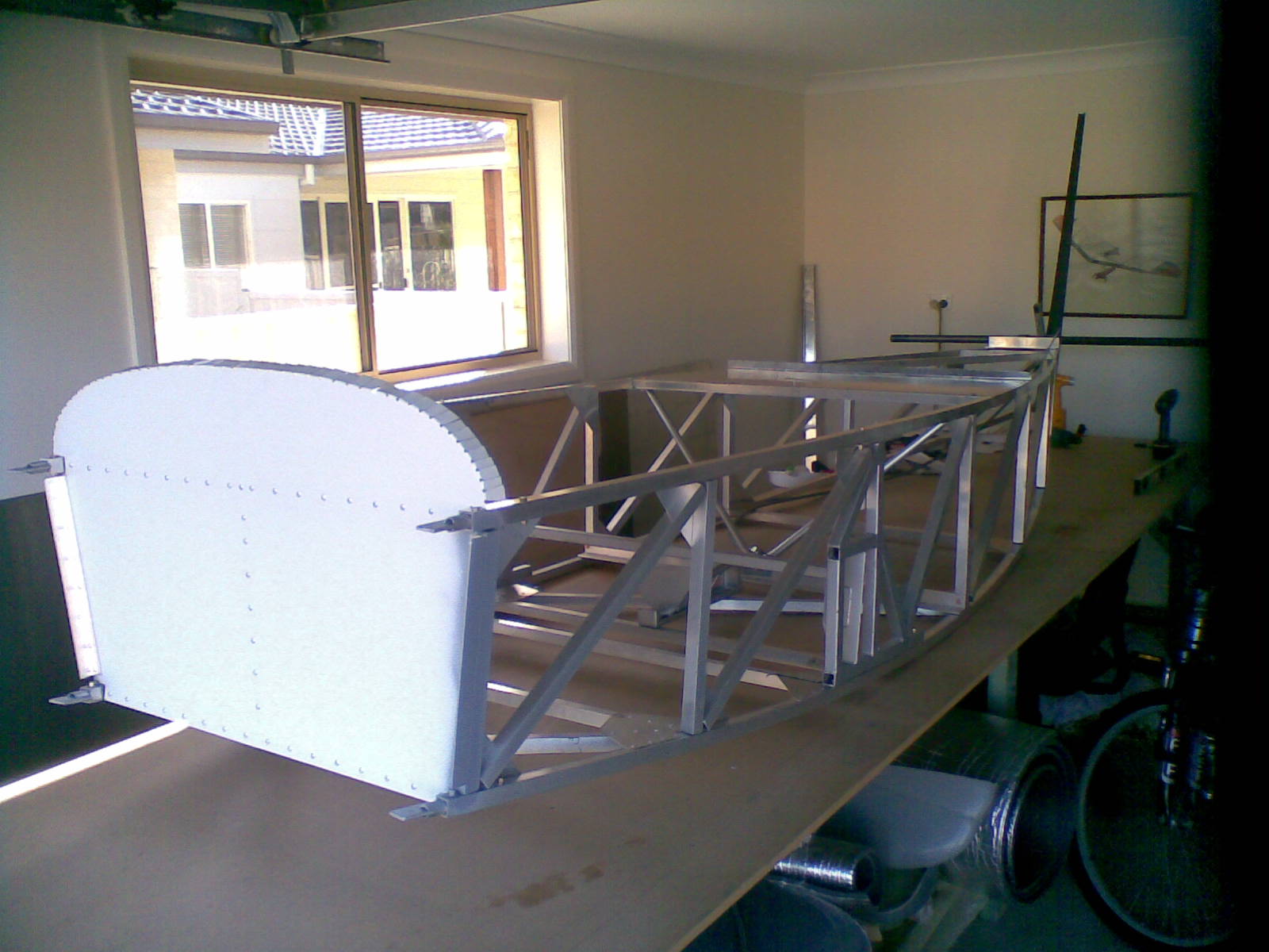

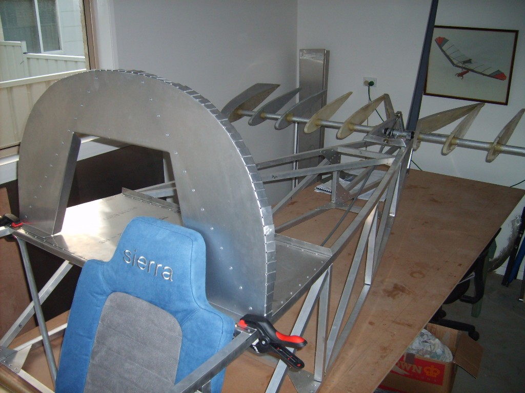

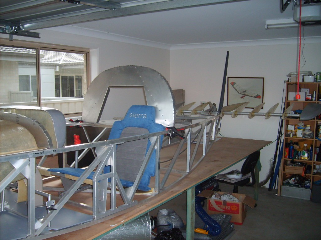

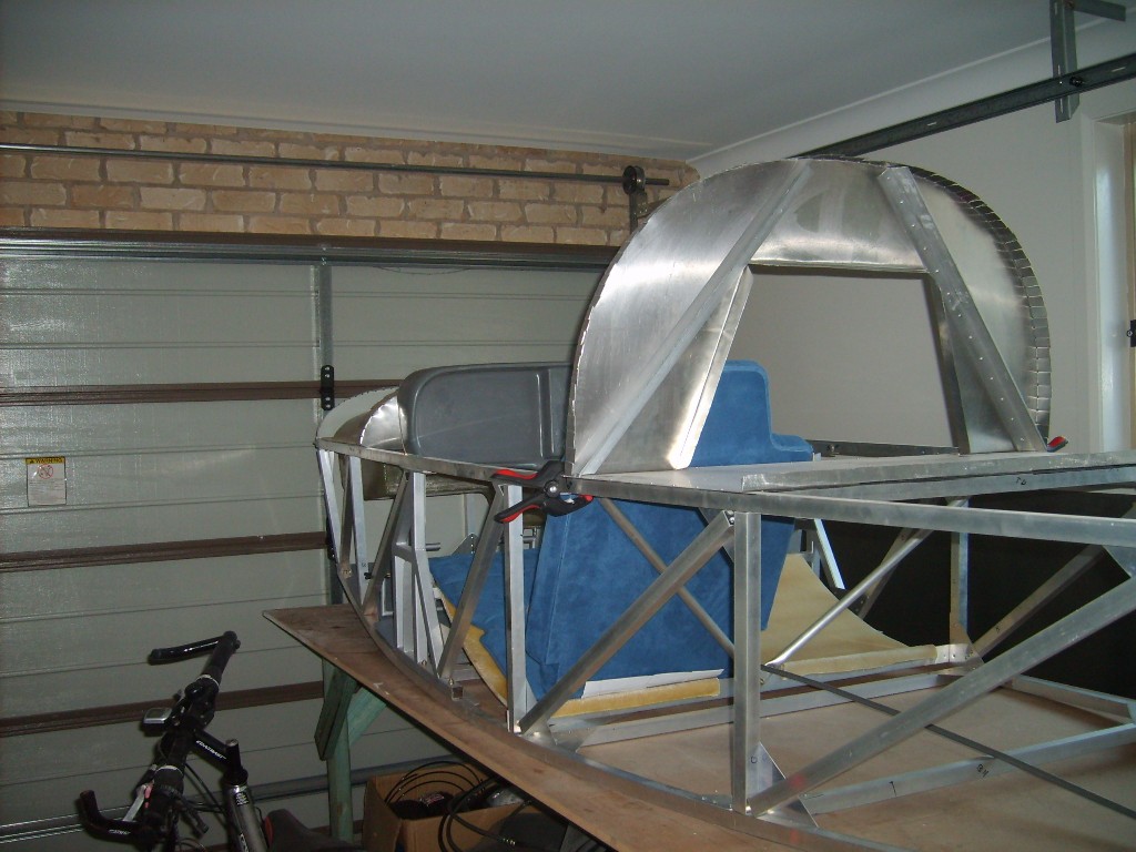

kgwilson Posted June 18, 2011 Author Posted June 18, 2011 I now have a completed fuselage frame with the firewall, seat bracing, parcel shelf and the elevator spar installed. I was about to install the cable and control box when I realised the cable was too short. Id been given a dual control cable by mistake & it is about 25mm shorter. I'll get the correct one next week but I'll just carry on with the build & install the floor & fuel tank next. The fuel tank will take a while I think as there are several bits to it with baffles that have to be fibre-glassed in, the 2 halves joined, fuel cock & drain plus the filler cap & neck. Boy did we have some rain this week. 400mm in 48 hours & on Tuesday morning at around 6:00am the manhole cover in the garage disappeared up into the roof cavity & water was forced in past the sectional lift door & all the Sioerra parts that were on the floor were now on a wet surface. Plus all the Aluminium sheet nicely stacked against the wall with the ply sheet in front got sucked off the wall & were now all leaning on the bench. This saved them from damage & the ply sheet was wet for about 15mm up from the floor. I dried everything and it all now sits on blocks. The ply dried naturally & there isn't even a water mark on it. My biggest shock came from finding a major abrasion gouge on one wing spar angle. This must have happened on the trip home & I never saw it when putting everything away. Anyway I now have a couple of good solid angle straight edges and work well as a manual sheet folder when clamped in a vise. One new spar angle required though. Here are a couple of pics of the build to date and the spar damage. I can't download photos from my camera at present due to our 11 week old puppy finding his was into the office and deciding to chew up the camera data cable. Luckily the phone camera & cable still work.  Â

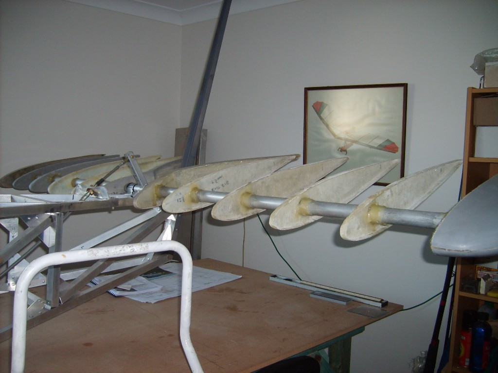

kjfab Posted June 19, 2011 Posted June 19, 2011 looking good kev.Well your hanger looks a little more comfortable than Garry’s ha-ha. Good to see your progress. i have replaced the prop on my sierra, wooden one that was on it before was being destroyed by all the gravel taxiways at Gawler so i decided to replace it with a bolly fibre ground adjustable one. i tried a 56" 3 blade and a 60" 2 blade. the 3 blade achieved about 800 ft/min and 120-125 @ 2800 rpm.the 2 blade achieved 1200 ft/min and 130-135 @ 2800 rpm @3200 rpm it was doing 150 not bad.no second price for guessing which one i choses. kev Â

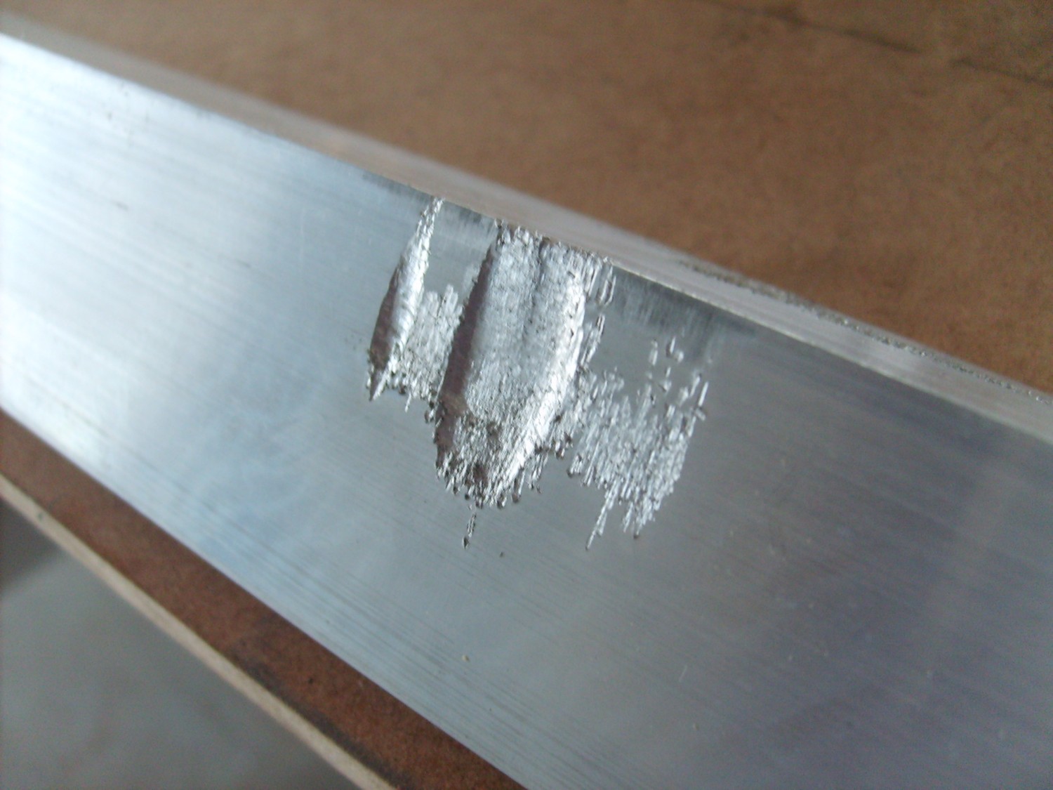

kgwilson Posted June 19, 2011 Author Posted June 19, 2011 Well the damaged one is now in 3 pieces. One 2 metre length is good for something. The other 2 1.1 metre lengths are now clamp straight edges. Â
Guernsey Posted June 20, 2011 Posted June 20, 2011 looking good kev.Well your hanger looks a little more comfortable than Garry’s ha-ha. Good to see your progress.i have replaced the prop on my sierra, wooden one that was on it before was being destroyed by all the gravel taxiways at Gawler so i decided to replace it with a bolly fibre ground adjustable one. i tried a 56" 3 blade and a 60" 2 blade. the 3 blade achieved about 800 ft/min and 120-125 @ 2800 rpm.the 2 blade achieved 1200 ft/min and 130-135 @ 2800 rpm @3200 rpm it was doing 150 not bad.no second price for guessing which one i choses. kev I hope Kjfab (my son-in-law) doesn't mind me adding to the above, but the performance with the Bolly prop is about the same as with Gary Morgan's wooden prop, it was only the stone damage that was the problem NOT the performance of Gary's prop. Alan Marriette.:thumb_up: Â
kgwilson Posted June 20, 2011 Author Posted June 20, 2011 I figured it was just because of the stone damage as Kevin came back from a flight along the beach the day before he left Taree & told us he'd got 150 knots & joined overhead at 140 knots. Garry has always claimed that the 3 blade props don't perform as well so you have proved this now. Cut the floor today & spent about half an hour trying to get it in without success. I've checked the fit both sides and front so its a matter of technique. Got it 3/4 in & then had a real hassle getting it out. Now I am going to trim it, sand and paint & then have another go. Kevin Â

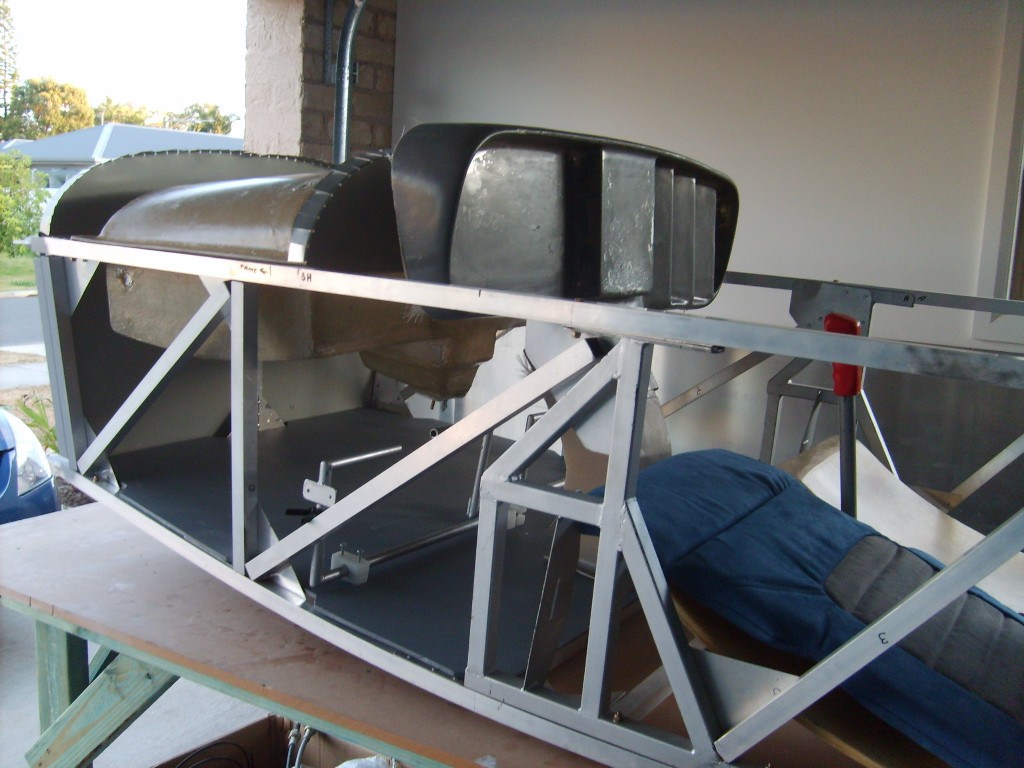

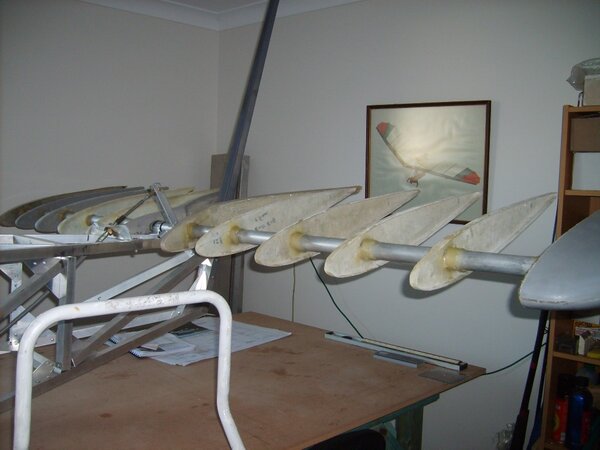

kgwilson Posted July 22, 2011 Author Posted July 22, 2011 Progress has continued with the build. I was concerned about getting the 2 halves of the fuel tank glassed together without any leaks but in the end this wasn't too hard. The secret is to get the Vinyl ester and Q cell mix to a paste that is not too runny so it all falls out of the joint area and not too stiff so it doesn't stick well. I had it clamped with about 30 clamps to get a good seal and after 24 hours I pressurised it with compressed air there were no leaks in the join, but I found 3 in the main tank, glassed those and then found another 2. Glassed those & re-pressurised and left it for an hour and no more leaks. I cut out the floor to shape and tried to get it in and couldn't so took it out and cut out the corners where it fits round the frame & then managed to get it in. I was going to take it out again and paint it before installing it permanently. That didn't work. I couldn't get it out again so I turned the fuselage on its side and primed & top coated it working around everything. I cut out the 2 bulkheads and bent the straight edges, drilled and bent the tabs for fuselage shape and installed the rollover angle on the rear bulkhead so these are ready to go. I got the correct length elevator cable and installed this with the control box and joystick. Next I drilled the holes for the elevator spar in all 12 elevator ribs. All this imperial sized stuff is a pain after a lifetime in metrics so I didn't have a hole saw the right size. Anyway drilled slightly smaller holes and honed them with a half round file and hung them on the spar. They weren't all perfectly lined up as I expected but with a bit more fiddling and and filing I got everything where it should be. I clamped them to the bench and glassed them in. Both sides are done and look nice and straight. Next I am installing the rudder pedals and brake master cylinders, fuel drain and breather and getting the main undercarriage leg cleaned up for its final cloth wrap and glass roving . This is to prevent possible de-lamination over time and hard landings. I have placed a few things like the pedals, seat and panel to give a better idea of how things end up. The panel will be much lower in the final install. Progress pics attached.      Â
