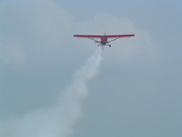

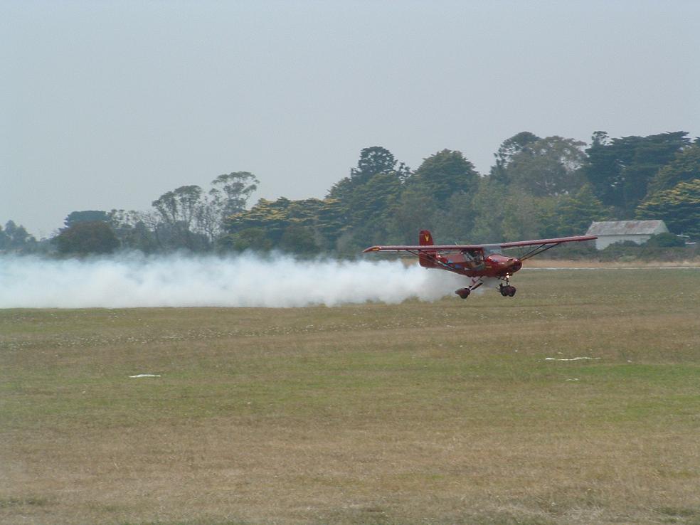

Student Pilot Posted May 28, 2006 Posted May 28, 2006 URGENT message for the guest post, if you know who owns the Gazelle in the picture tell him not to fly it anymore until he gets the engine checked out! Every picture posted has the Gazelle pouring smoke out, maybe he's overboosted the consosinator?

Student Pilot Posted May 28, 2006 Posted May 28, 2006 At that extreme climb angle (3.5 degrees) for a Gazelle, that smoke must be coming from a JATO bottle. Must be close to gross with 2 folks, 15 litres of fuel and 15 litres of vegetable oil that's injected into the exhaust?
pylon500 Posted May 28, 2006 Posted May 28, 2006 C'Mon Glen, you're not getting all cynical on us are you? I've been flying in a Gazelle with half fuel and a couple of 'average' blokes on board, and I thought 300 fpm was doing all right! I'ts not like it was 40C outside, I thought it was only about 37C!! Still there's some good thermols around everly. Arthur.
Guest micgrace Posted May 28, 2006 Posted May 28, 2006 Hi Arthur, I'd thought I'd weigh in with my 2 cents worth. Having flown a Gazelle a fair bit, surely you can do better than 300fpm. at 55 climbout, two of us average about 500fpm. (at 30C, 40')Apart from one notorious example that I flew when first released which nearly put me off the breed for ever. Must say, very good aircraft for beginners. Can do almost anything within reason. I notice that the rubber shear blocks in the suspension deterioate fairly quickly, and I'm somewhat dubious about the aerilon attachment method i.e. for long life. As for stall, well, what can you say, full stick back to get anything that resembles what one should "feel" like. Unfortunately, the rather benign characteristics might lead people into trouble on other types. Micgrace :)
