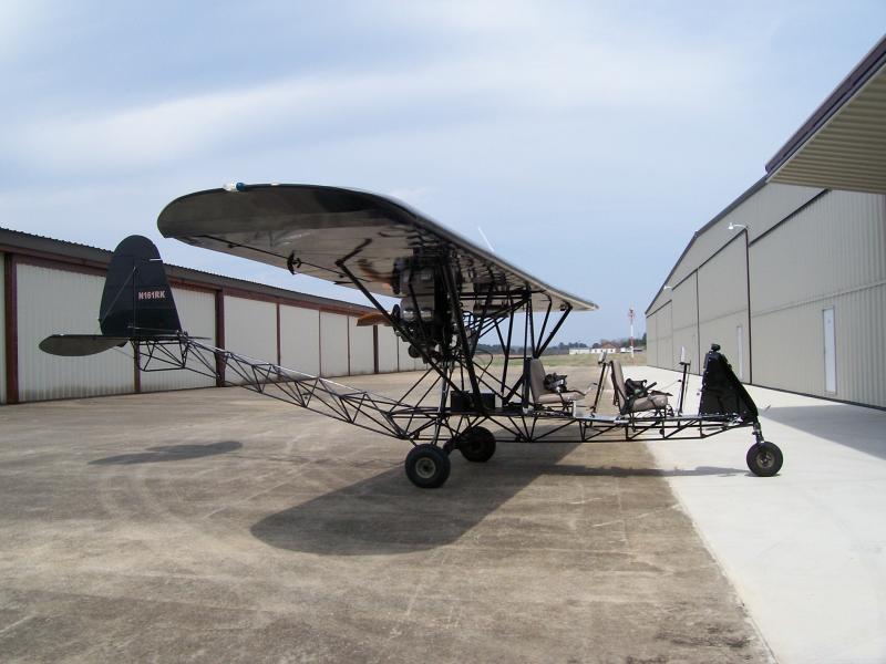

Guest Terry Capps Posted March 30, 2011 Posted March 30, 2011 Breezy Thanks for the info. The Breezy has a O-290D engine 130HP Terry,The Breezy looks like a load of fun. I saw a Breezy at the Evans Head flyin in the state of NSW in 2010. Has yours got the 0-200 engine? In relation to the battery connection for jump starting you need to exercise great care in the installation. I would strongly suggest that you use an isolator at the battery so that the cables are only live when you need to jump start. Consider carefully the mechanical protection of such cables as any damage when they are live can be catastrophic. Consider the impact of vibration and heat on the cables (minimum double insulation,better with additional protection). Consider the cable weight, copper is heavy and you need large gauge. Keep the cable as short as possible to minimize voltage drop. Do not place the plug connection or the cable installation where it can be damaged in a minor impact such as a nose wheel collapse (not an issue if it is isolated). Just a few pointers. Suggest you do a search on this issue in the Posts section of this site because I believe the need to jump start can be eliminated with certain fixes on the hard starting issues with the Jabiru. David
DAVID SEE Posted March 30, 2011 Posted March 30, 2011 Freekin heck......130hp. that thing should climb vertical.... Serious though, it sure looks like you can have some serious fun on that. Welcome to the site. Cheers Davo.
Guernsey Posted April 16, 2011 Posted April 16, 2011 Stone the crows!! I can see why it is called a Breezy, with that power plant it should be called a Huricane. I would fit a head restraint on top of the seat to prevent serious whip lash when you hit the throttle. I bet you find your J230 a bit meek and mild in comparison. Alan.
