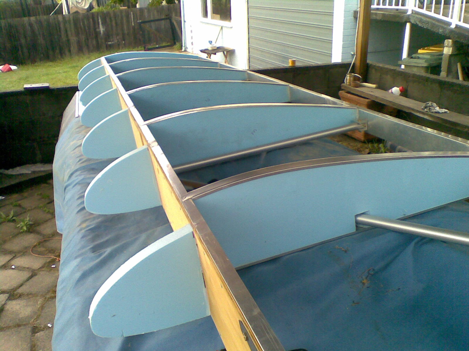

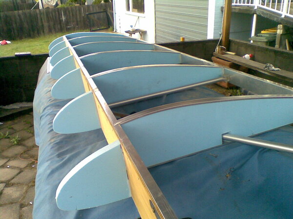

Aero28 Posted April 12, 2011 Posted April 12, 2011 Hello All, I would like to add my bit to this discusion , The pic has 30mm wide foam ribs with .6 ally cap strips top and bottom. Sikaflex bonds the cap strips to the foam and pop rivits on the front and rear spars. The plane in my avatar has foam ribs.
old man emu Posted April 14, 2011 Author Posted April 14, 2011 It is interesting that Aero28's ribs are 30mm thick when made from blue styrofoam. I assume that these have been cut from a thick sheet of foam, probably 100mm thick. There is no side covering attachd to the ribs. The foam I am looking at has expanded PVC foam between stiff plastic sheeting. I think that the plastic sheet would give the sheet a good deal of rigidity. I also notice that Aero28's ribs don't have lightening cut-outs. That would add to the resistance of teh rib to vertical forces. I must compare the weight of ribs cut from foam and plywood to see if there is any weight saving, which ultimately was one of the reasons I was looking to using the sheet. OME
Aero28 Posted April 14, 2011 Posted April 14, 2011 The foam comes in sheet form and is actually building insulation for walls, I think 25 and 30 mm thick. Dow Corning product. Each one of those ribs weighs 230 gramms with the cap strips. You don't really need to worry about lateral/sideways strength with ribs as the covering top and bottom takes care of that so would think that sandwich panel would be overkill. Cheers 1
